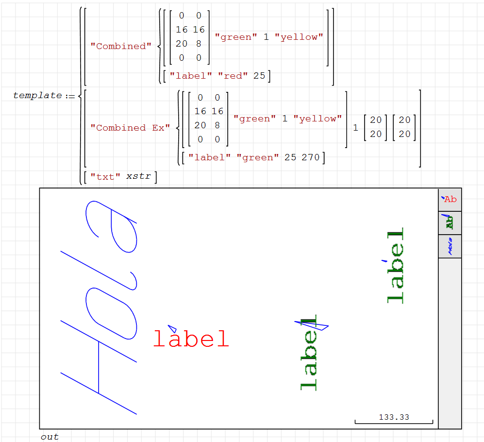

Hello, please someone knows how to rotate text in modeller region?
Thanks Alvaro, your implementation is very interesting, but I would like to know how to rotate the normal text (green label) without distorting it.
#66 Posted: 2021/8/10 07:59:32
1,441 likes in 2,932 posts.
Use 270 as 4th argument to rotate 90° counter-clockwise

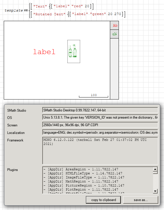

597 likes in 1,377 posts.
Text Rotation in modeller region with 270 as fourth argument is not working under Linux.
I had encountered this several months ago, maybe years. Forgot to report it.

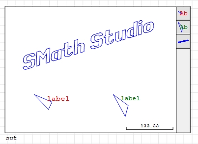

#69 Posted: 2021/8/11 10:56:20
Thanks Davide for rotated text in Modeler.
modeller Rotate Text.sm (177.71 KiB) downloaded 1442 time(s).
I'll look into it, thank you.
This is how it is rendered with rotated text.
