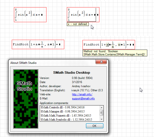

#12 已发布: 2016/3/2 09:11:41
325个赞和1个踩,共2,052个帖子。
Hi Andrey!
Thanks very much for the new version.
I observe the following.
1. FindRoot function does not work.
2. Definite integral does not work.
It will not work for me as well, although I have to admit that I installed bunch of plugins.

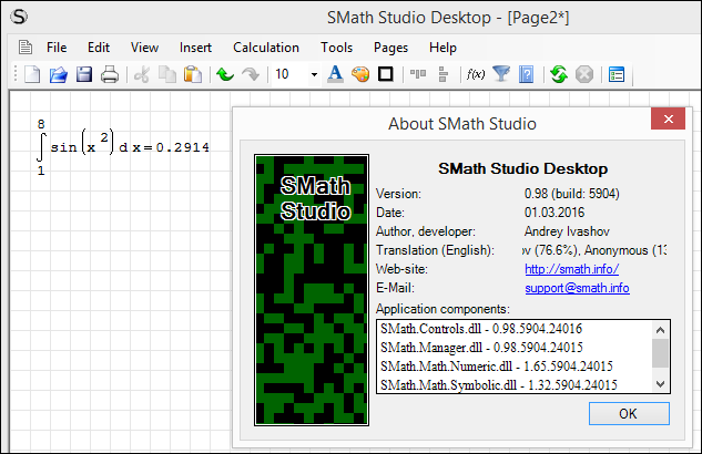

However, fresh install with only Davide's Nonlinear Solvers (FindRoot() function is from there) and Martin's Smath Handbook will give this
1. FindRoot() will give the same error as on the picture
2. Definite integral works
Davide Carpi 2016/3/2 09:39:00

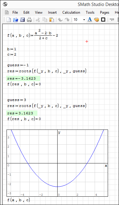

I have no problems with integrals, no exceptions in the files above (Reservoir Flood Capacity Estimation-R1 / TestSum).

#19 已发布: 2016/3/2 11:29:36
NDTM Amarasekera
NDTM Amarasekera
130个赞,共352个帖子。
Hi Radovan,
I had a bunch of so many plugins.
So, uninstalled, including all plugins in %APPDATA%/Smath folder and did a clean install.
My problem was solved.
Thank you very much.
