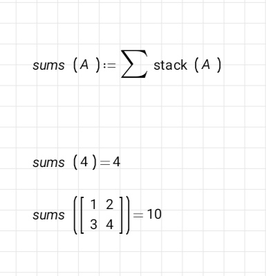

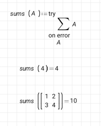

#2 已发布: 2022/4/18 09:50:44

#5 已发布: 2022/4/18 10:22:36
1,443个赞,共2,936个帖子。
You're welcome
Note that using the stack approach you don't need the zero
