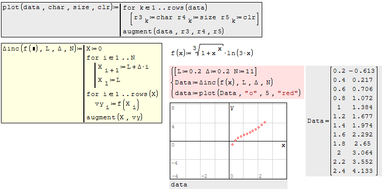

Is this what you need?

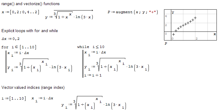

You can do the job using a while loop but it is just one option (perhaps not the most straightforward one).
loops.sm (10 KiB) downloaded 948 time(s).

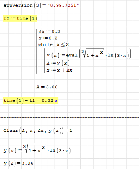

Absolutely, and there are several ways.
If you need a step-by step feedback on the fly you can use breakpoints (menu of math regions) and the debugger window ("View" menu). You might have to store the intermediate results in a dedicated variable though, to don't look into the whole matrix at each step.
Also you can use the function trace() and the output window, or you can build math strings using concat() and other functions, or maybe something more complex using the script region plugin by uni.
loops-1.sm (30.01 KiB) downloaded 866 time(s).
