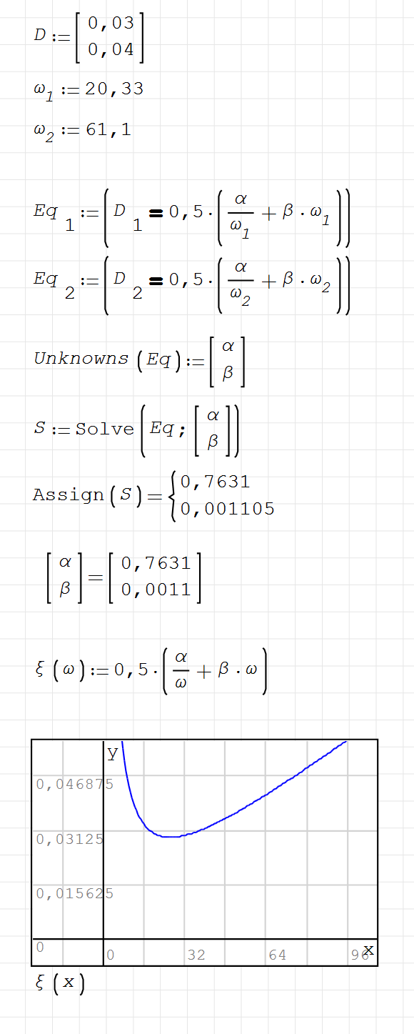

hi,
I used the Solve function a lot before but for some reason it does not work for this simple example.
I need to get the RayLeigh Damping factors alpha and beta using two frequencies, so two simple simultaneous equations should do it. tried using Solve but no luck.
Does anyone know why it is not solving?
Thanks in advance

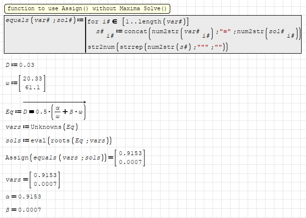

#3 Posted: 2022/4/5 18:24:50
597 likes in 1,377 posts.
You can use roots() for your function. And a vectorize() can simplify it.
However, to use Assign() you will need this function to merge vars and solutions.
Assign_without_Maxima Solve().sm (7.36 KiB) downloaded 1026 time(s).
Mo 2022/4/5 22:22:00

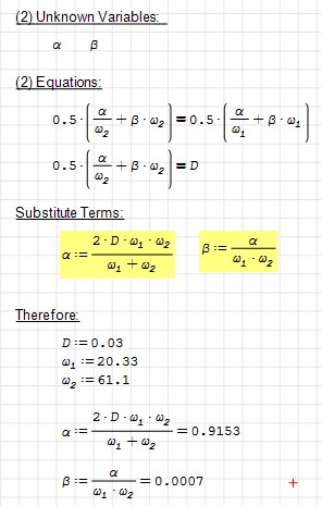

⚜ Kenny Lemens, P.E. ᵂᴵ
85 likes in 179 posts.
Greetings,
Another approach would be to use some elbow grease, you can substitute terms by hand and solve for 𝛼 and 𝛽:
Keypress (You can copy/paste the following into your worksheet):
α:{2*D*ω.1*ω.2}/{ω.1+ω.2}
β:α/{ω.1*ω.2}
*NOTE: ω.1 and ω.2 shown above are variables with subscript, they are not vectors ω[1 and ω[2; You should be able to substitute ω.1 for ω[1 if that serves your purposes.
- Kenny Lemens, P.E.
Mo 2022/4/6 11:57:00

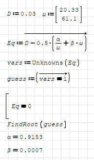

... more in there from native Smath code.
Solve FindRoot FORUM.sm (10.9 KiB) downloaded 1022 time(s).

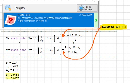

Greetings,
If plugins are considered, you can also consider the use of Maple:
In the image I posted, the 'equal sign' shown on those two equations are actually symbolic equals; keypress: [ctrl] + [.] instead of keypress [=].
Kenny Lemens, P.E.

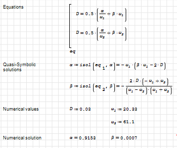

Hi. The isol solution, using only the Mathcad block plugin.
isol_example.sm (68.13 KiB) downloaded 985 time(s).
isol_example.pdf (34.57 KiB) downloaded 525 time(s).
sergio 2022/4/12 05:01:00
