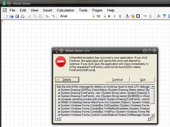

Also, the program crashes if I try to change the font family:
I placed all font families in the folder mentioned before.

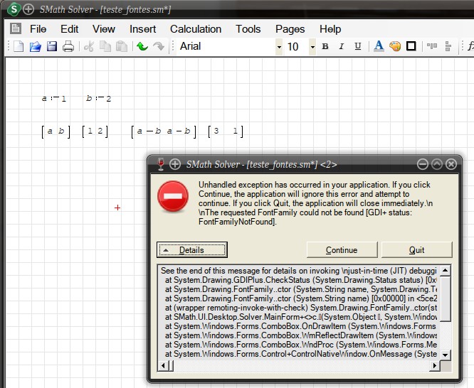

Same behavior, with mono:
#6 已发布: 2022/7/3 08:58:31
600个赞,共1,381个帖子。
I still see wine symbol at titlebar of error message.
Please make sure you have installed mono package installed.

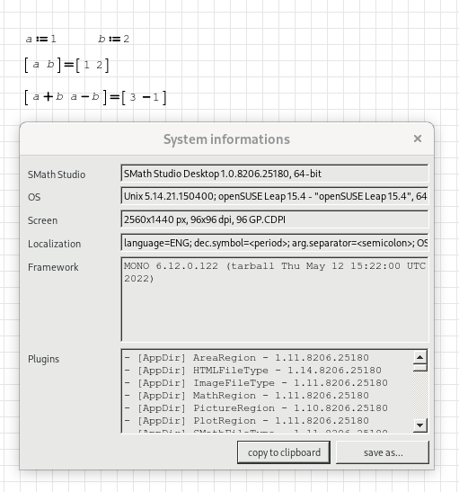

I have tried Smath with openSUSE_leap_15.4_live iso.
Seems everything is fine and working as it should be.
At first I tried with appimage I created. It is v0.99.7822 and it worked flawless.
Then I have installed mono-complete and downloaded latest v1.0.8206.
And there was no issue with it either, no problem with symbols or anything else.
Can't help you further from here without additional information.
