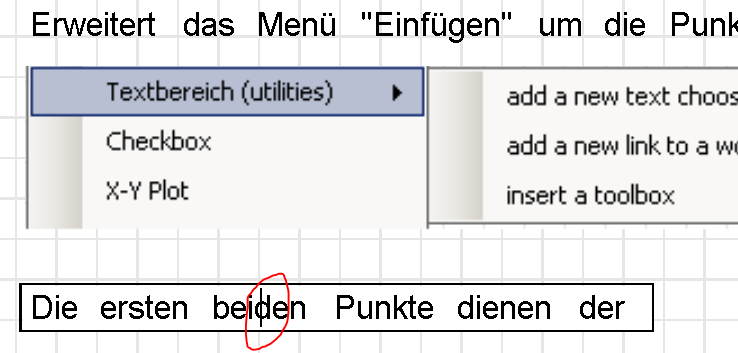

This plugin adds a couple of items in the "Insert" > "Text region utilities" menu to add new text regions with custom fonts and/or with links.
A "Toolbox" region is provided to do more actions on the worksheet (edit text/links, add links from paths, convert TextRegions into WriterRegions, search and replace text in the whole worksheet)
  • requirements: to have all the features, SMath Studio 0.97.5737 or later and WriterRegion 0.3.5800 or later;
  • installation: SMath Studio: Tools > Plugins... > Online Gallery (be sure to have "Exclude beta-versions" unchecked);
  • documentation: refer to the interactive handbook of Martin Kraska (Tools > Plugins > Interactive books);
  • sources: the updated sources are available in the SVN repository.
NOTES:
- the font dialog uses only Font-Size, Font-Family, Bold, Italic and Underline attributes;
- the font size is taken from the built-in toolbar, but the choosen font settings are not applied to the standard font;
- to use a link between worksheets, the file in which you add the link must exist (the empty temporary file provided launching SMath must be saved before clicking the link created with this plugin);
- the toolbox region requires a refresh of the worksheet before using it.
>>> PLEASE REPORT IN THIS THREAD ANY ISSUE, MORE DETAILED AS POSSIBLE <<<

There are cursor placement issues in texts with non-monospaced fonts. May be that is a reason why font change is not supported natively so far.

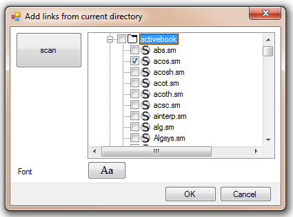

UPDATED SMath Studio 0.97.5346
- Toolbox: new feature "add links (batch)";
- Fixed bug on auto calculation disabled;
- Libraries updated.
add links (batch)
  • This feature explore all folders and sub-folders from the path of the worksheet, looking for *.sm and *.smz files;
  • If the worksheet is new (not saved somewhere) the option is disabled (if the file is saved and the option is still disabled try refreshing the worksheet);
  • You may include or not the files using checkboxes on a tree view;
  • Any link created is relative to the current location of the worksheet;
  • Links are added below the toolbox, regardless what is already on the canvas, using the same horizontal alignment.

#20 已发布: 2014/9/4 08:59:45
1,362个赞,共2,276个帖子。
Really nice. I like the batch scanning feature.
How about using the Document title property from the file header as (possibly multilingual) text in the link regions?
