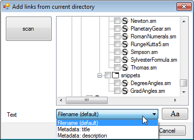

How about using the Document title property from the file header as (possibly multilingual) text in the link regions?
Good idea, I'll explore it.

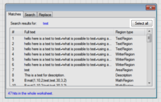

* to have a checkbox to see all findings as selected; this would allow a better global look.
That's a nice idea, I'll see what I can do. DELIVERED

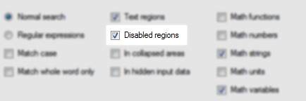

* to search also in the disabled regions (it seems that as now, only the active regions are examined); eventually by checking a box.
This option already exists, doesn't work?

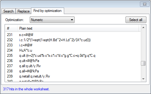

#28 已发布: 2016/2/11 20:51:31
1,443个赞,共2,936个帖子。
PLUGIN UPDATED
- Search & Replace: added new tab "Find by optimization";

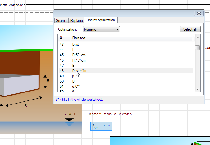

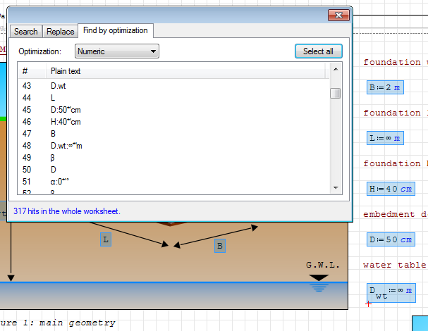

Hello Jean
Not exactly, the "Find by optimization" tool scan the math regions in worksheet looking for the choosen optimization.
If you click on a single result, the worksheet scrolls to that region and select it
2016-02-12 09_11_55-SMath Studio Desktop - [Bearing Capacity_2013.00.01.sm_].png
If you click on the "select all" button, all the found regions are selected
2016-02-12 09_13_44-SMath Studio Desktop - [Bearing Capacity_2013.00.01.sm_].png
Any further action on the optimization can be done on the canvas (right click > optimization)
Obviously you don't need this if you want a worksheet with an omogenous optimization (CTRL+A -> context menu on a math region -> optimization), however a sanity check is always good practice.
Done. Metadata title or description can be used as text of the hyperlinks (on *.sm files, if available, otherwise the filename is used)

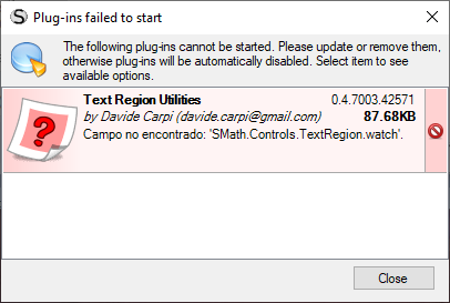

I seem not to be able to install the TextRegionUtilities plug-in with the latest version of Smath Studio. I get the following message when I try to install the plug-in:
Field not found: 'Smath.Controls.TextRegion.watch'.
appVersion(4)="0.99.7045.23606"

1,443个赞,共2,936个帖子。
Thank you, confirmed. That property in the API is no more available, I'll check what can be done.
