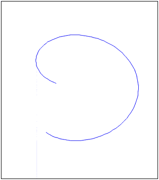

This method was suggested by the author of the "Method of Draghilev" prof. Alexei Ivanov.
1.st through the matrix of three columns (x, y, z) to construct
3d graph and select the desired Rakurs;
2.Using linear coordinate transformations turn
all points of the matrix at an angle (angles) corresponding
Rakurs and obtain a new matrix;
3. Out of three columns of the new matrix choose two and
substitute them in 2d graph;
Animation shows two first surface constructed A.Ivashev second
V.Mezentsev (Bottom). The animation is done on a flat graph.

Animation spatial mechanisms
To calculate the position of the mechanism will use
techniques developed A.B.Ivanov.His work on 3d
animation mechanisms made in Mapl, publishes A.B.Ivanov
online
http://forum.exponenta.ru/viewtopic.php?t=12842
Of the examples from this site I suffered in a programming environment SMath Studio

Rotation About an Arbitrary Axis in Space
The algorithm is taken from the book
. F. Rogers and J. A. Adams. Mathematical
Elements for Computer Graphics,second edition. McGraw-Hill Publishing Company,
1990,pages 121-127
Rotation2.smz (9.05 KiB)已下载 1428 次。

Rotation around an arbitrary axis defined by two points.Continuation
https://en.smath.info/forum/yaf_postsm30728_Transferring-three-dimensional-image-on-a-two-dimensional--flat--graph-by-prof--A-B-Ivanov.aspx#post30728
Rotation3.sm (35.34 KiB)已下载 1346 次。

The spiral curved along a given 3d curve
Spiral1.sm (21 KiB)已下载 1306 次。
Spiral4.sm (20.75 KiB)已下载 1391 次。
Spiral5.sm (19.92 KiB)已下载 1346 次。
