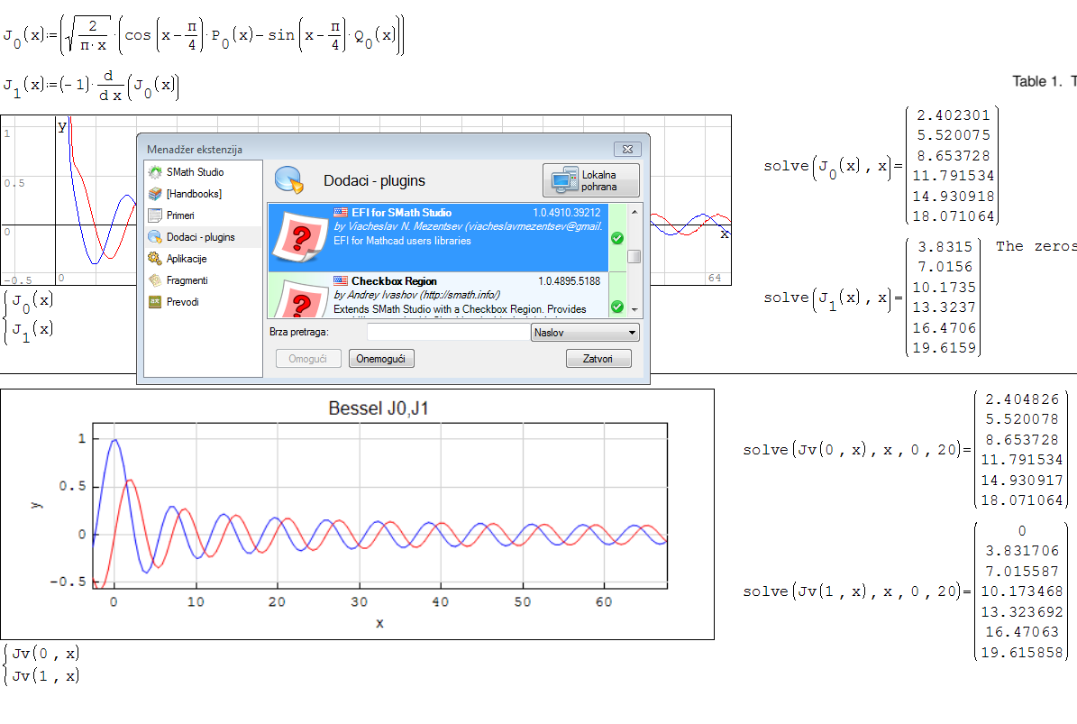

It seems I had a lucky guess this time. I've seen the EFI plugin in the Gallery. Installed it first and then copied the mathlib.dll in the place you mentioned. Bessel and other functions are back . Here is the result using the file by AlphaBeta. By the way, this much faster than using the approximation formulae.

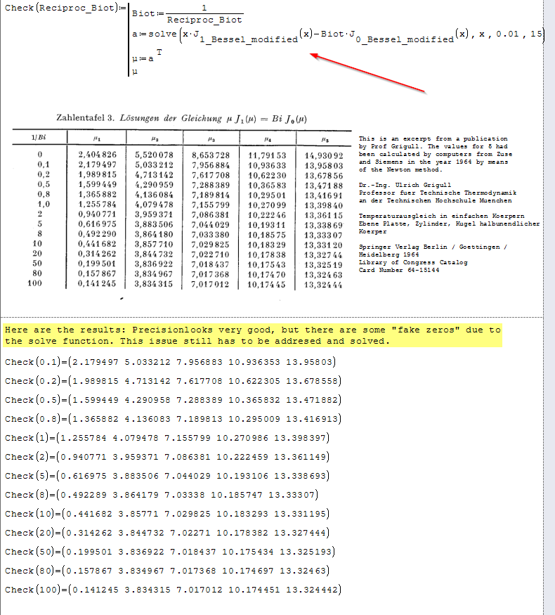

The results from solve() depends on the equation, range and decimal places (Tools|Options|Calculation Decimal places). See the result if you change the equation, give different range and set 15 decimal places.

thank you for your hint. I know that the solve function will produce some "ghost-zeros" in certain cases depending on the function, the range and the precision. I have sorted this out before by means of a little program within SMath using BiSection or NewtonRaphson, or using the initial zeros and then making a second, more refined "solve"-run using closer ranges. Additional knowledge about the functions periodicy is also helpful here.
Yesterday I was happy that it at least does work in principal now. ( The last Bessel function I have seen was 25 years ago)

By the way, increasing the precision in the program setting did not improve the situation.
But of course narrowing the range does remedy the situation. But such things need to be done "manually" and with knowledge about the function.
Or can be automatized by means of an algorithm for solving a very specific problem, but not in general.
