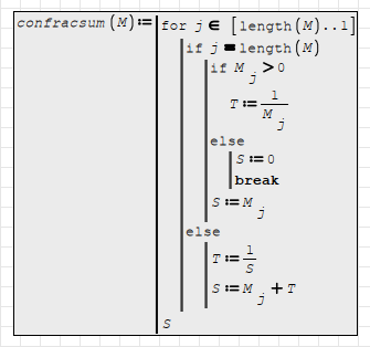

WroteHas anyone made a function in Smath for factoring a number into a continued fraction ...

WroteHere is a sample for your question ...
Thank you very much for the answer. I arrived at a very similar relation, but which did not work because I omitted to declare the function variable at the beginning of the program in the right member of the definition relation. Using MathCad quite often (where the variable / variables of the function are automatically declared only by mentioning them in the left member of the definition relation) I tend to apply the same rules in Smath. Thank you again.
Yes, in most advanced profitable.
Best to save a copy before experimenting
Jean.
ConfracNUMBER Copy.sm (46.11 KiB)已下载 1471 次。

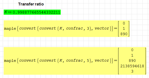

@uni: The advantage of the relationship is that it takes up little space in the worksheet. The disadvantage of designing such a relationship is that the component functions (convert, confrac, vector) are not predefined anywhere in the program's toolbars (at least not in the version I have). Maybe in newer versions there are predefined functions for these functions.
@Jean Giraud: As a former engineer (currently retired), I base it on practice, simplicity and efficiency. Therefore, in my applications, I don't need anything else than a vector of the decomposition of a decimal fraction into a continued fraction. I used this function (confrac) to calculate the number of teeth of several pairs of gear wheels, in order to obtain a certain transfer ratio K.
On another note, everything you have presented here probably has multiple applications, depending on the field of interest. So thank you all.
