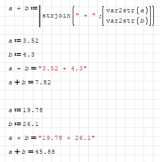

Not how you wanted in single line but possible.

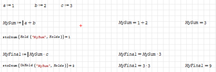

Hi. This is another way.
intermediate_results.sm (14.4 KiB)已下载 1257 次。

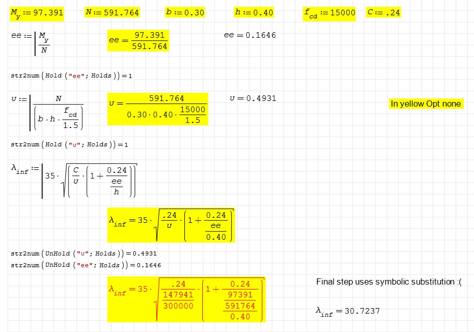

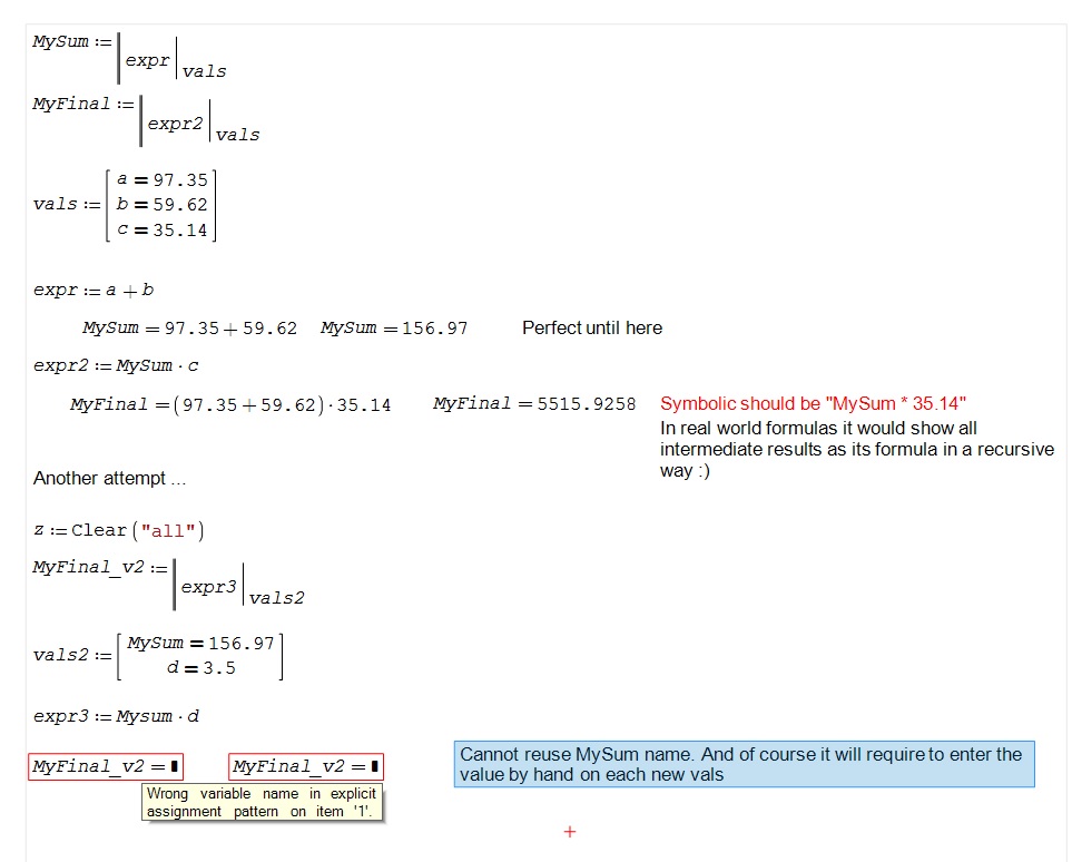

Hi Razonar,
it works perfectly well for initial formulas, but cannot find any way to use a previous result on a new one.
Cannot put all values in a single vals, the simbolic substitution will show in the second formula the formula (not the value) of the calculated value (ee).
Cannot either reuse names.
Any idea?

I have an idea, if someone has better you can use it.
Rewrite expressions and hide them inside areas.
Configure page setup with "no areas".
When you save as pdf or print, it will show as continuous.
MySum.sm (8.16 KiB)已下载 1232 次。
But here is a humble suggestion.
SMath was not coded with intent to show intermediate results.
You are going to struggle very much with this approach.

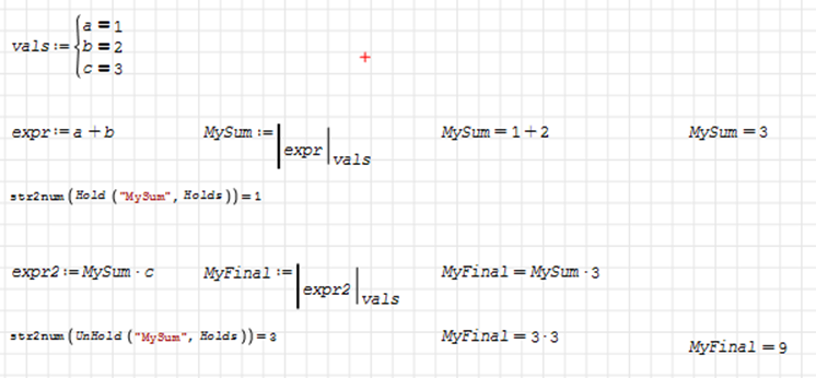

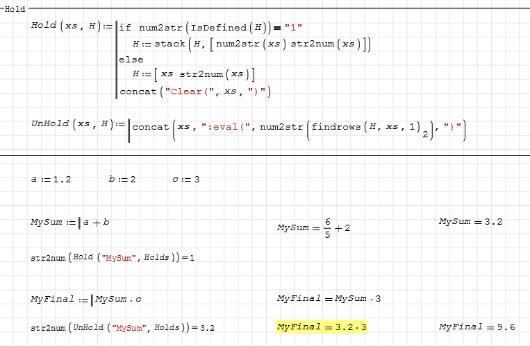

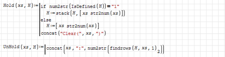

Hi. This is another way. The feature request actually is here.
Using
You can get
Hold.sm (9.78 KiB)已下载 1231 次。
or
Hold_v2.sm (9.06 KiB)已下载 1230 次。
sergio 2021/10/25 14:18:00

Too easy to be true Final step uses fractions to substitute ... Use a:=1.2 in your example and you will see.
Actual formulas are for sure more complex so the data display is really confusing.

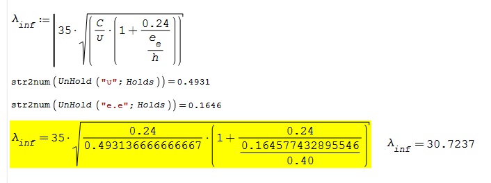

Hi. Insert eval( ) in UnHold
#14 已发布: 2021/10/26 05:48:01
DeepButi
DeepButi
0个赞,共7个帖子。
You are a genious. Thks!
Just trying to figure out how to avoid too many decimals now
Decimal places set to 4 everywhere

Hi. Thanks! ... but ... not ... but thanks. That behavior seems to be a bug or an oversight: set the decimal places in the output of an expression with None Optimization.
In the meantime, this could be a workaround, but could be dangerous, because change the stored value. Actually I don't really recommend it.

Ok, ok. Really it's a BIG THANKS.
:round(eval(... works perfectly well
:eval(round(... didn't.

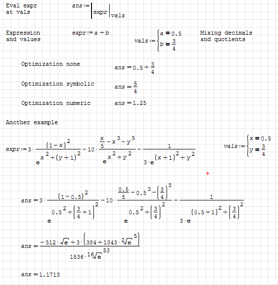

Another way...
