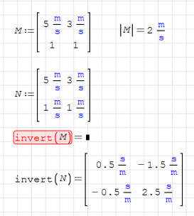

Valery Ochkov
Valery Ochkov
67个赞,共716个帖子。
Mathcad vs SMath
#2 已发布: 2024/5/21 13:44:42
600个赞,共1,381个帖子。
There is invert() function for that but it won't work with mixed units.

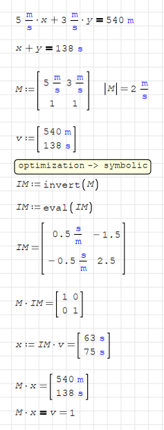

#3 已发布: 2024/5/21 17:10:58
600个赞,共1,381个帖子。
Nevermind, I found a way for invert.
Here is your solution.
invert.sm (9.09 KiB)已下载 1792 次。

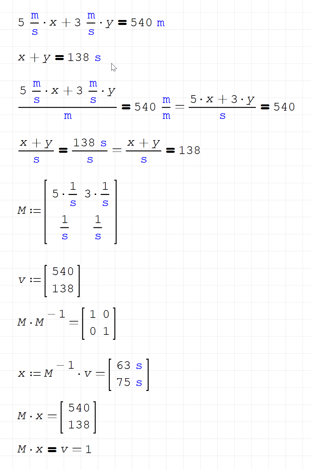

#4 已发布: 2024/5/21 18:19:03
127个赞,共342个帖子。
I take inspiration from Overlord
