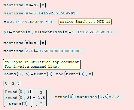

#7 Posted: 2022/10/22 08:55:34
Natural fractions.
How can I enter a value to display the integer and fractional part
... lat brick in the wall from not acknowledged.
