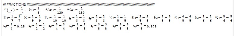

If you wish for special characters (e.g., 「½」) to be treated as a number, you can declare then as such:
½:0.5
      There are a few of these fraction characters you can define as a variable:

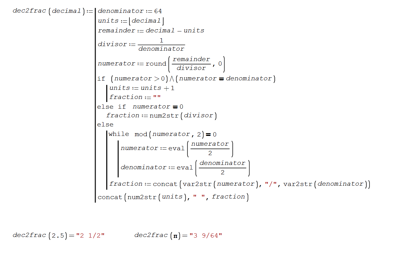

Natural fractions. How can I enter a value to display the integer and fractional part, like 2½. Maybe somewhere there is a full-fledged Help?
Maybe this can help:
dec2frac.sm (6.59 KiB)已下载 1316 次。

"dec2frac(decimal)" Works for me! Thank you! I've been using a sheet from MathCad, which is not as clear:
