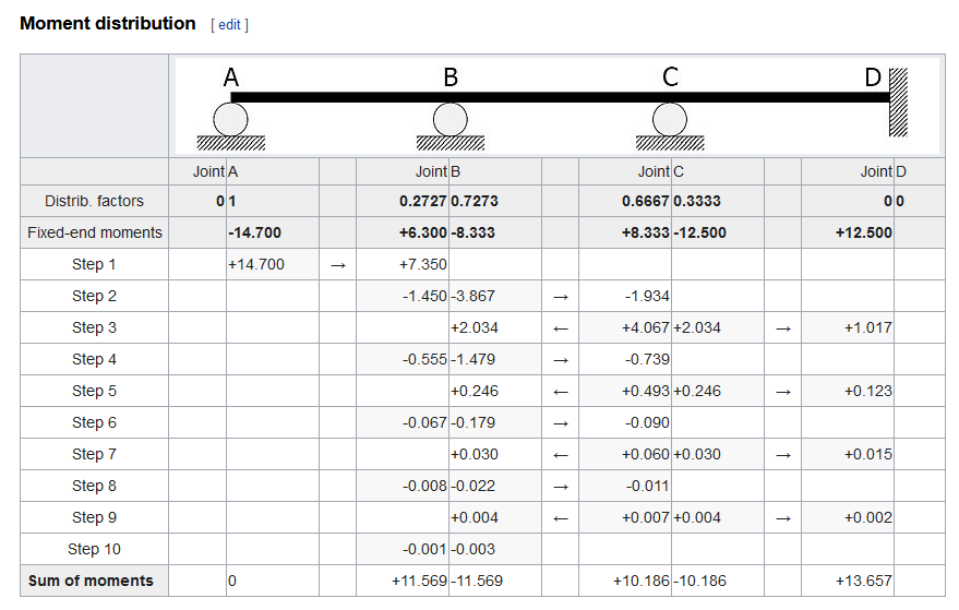

Has anyone performed the Hardy Cross / Moment Distribution Method on a continuous beam in SMath? Are there any examples of this on the forum?

#3 Posted: 2021/2/19 21:41:04
hanskl
hanskl
7 likes in 158 posts.
Jean,
Thanks for having a look.
Its the part below that is the technically new/challenging part for me. I cant quite visualize the "framework" to set it up if you will.
Best regards,

#5 Posted: 2021/2/20 09:43:48
steps are the missing links ... out of the blue !
