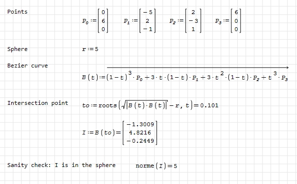

#9 Posted: 2021/9/15 20:57:18
1,106 likes in 1,784 posts.
Hi. In the attached how to solve the problem numerically. Notice that B(t) must to be defined using vectorize, because SMath don't expand the scalar by vector products.
Sphere and Cubic.sm (8.86 KiB) downloaded 927 time(s).

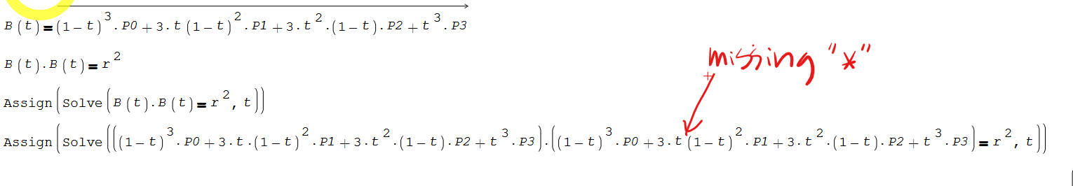

OK, I've fixed the error, but now it says: «r is undefined». Sorry, it's really hard to understand what to do and I can't find any proper docs about it...
Sphere and cubic Bezier curve intersection points.sm (4.62 KiB) downloaded 968 time(s).
#13 Posted: 2021/9/16 08:43:30
Necronomicron
Necronomicron
0 likes in 8 posts.
I really don't get what's wrong now...
Sphere and cubic Bezier curve intersection points.sm (12.04 KiB) downloaded 998 time(s).
#14 Posted: 2021/9/16 09:40:26
Oscar Campo
Oscar Campo
135 likes in 309 posts.
There is a missing "*"
#15 Posted: 2021/9/16 11:07:40
Necronomicron
Necronomicron
0 likes in 8 posts.
Thank you! But what should I do with «r is undefined»? 🤔
#16 Posted: 2021/9/16 11:12:25
Oscar Campo
Oscar Campo
Are you sure you are using the option "Symbolic Optimization"?
You must right-click over your equation, then choose Optimization-Symbolic
#17 Posted: 2021/9/16 11:40:06
Necronomicron
Necronomicron
0 likes in 8 posts.
Thank you very much! It worked! However, the roots are so long... Not sure I can use them... Thanks anyway! 😊
Hi. Notice that P0, ..., P3 are vectors with 3 components, not scalars. You can't get the distance with B(t).B(t) using P's as scalars.
