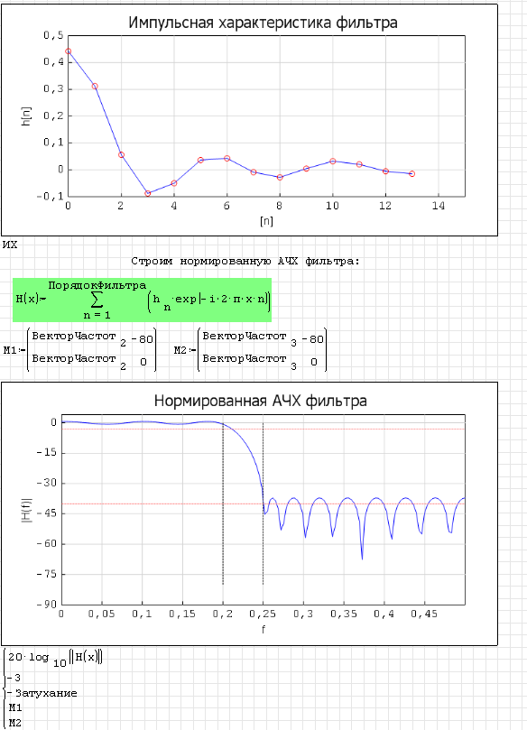

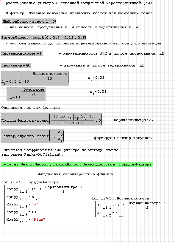

remez(vg, vr, vw, n) Returns coefficients for a FIR filter of length n generated by the Remez exchange algorithm.
Arguments:
- vg is a real vector, a grid of frequencies between 0 and 0.5.
- vr is a real vector of values between 0 and 1, length: vg / 2. Contains the frequency response over vg.
- vw is a real vector of values between 0 and 1, the same length as vr. Contains error weight over vg.
- n is an integer, the length of the filter.

Plugin updated. Please try.
Changes:
- remez2() function added.
Links:
1. Sources from tomtit
2. Test example for remez2().
Calculation of digital filter coefficients for emulation/design High-Class Audio Multi-function Digital Filter SM5842AP/APT.
