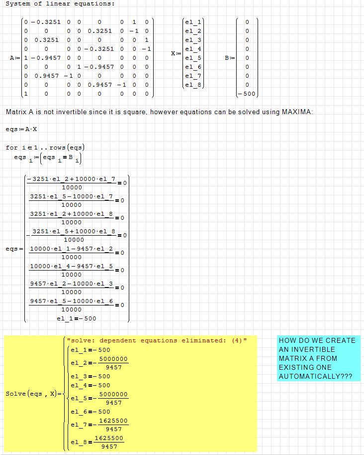

Anyway, from educations perspective, is the a way to solve the following without using Maxima:
solveMaxima.sm (16.48 KiB)已下载 1221 次。

- Would you happen to know the answer from my previous post? I would prefer not to use Maxima unless I have to...

Ioan, one of the reasons why I am not going the FEA way for this task, is because in my design office there is a strong opinion against it (not the best tool for the task? influence of late James MacGregor? - I do not know) Those zero force members almost always end up carrying some load.. Anyway - I must do it the sum(F.x) = 0 & sum (F.y) = 0 way.
So if you, or anyone else know how to solve equations from post 11 the SMath way (3 equations, 4 unknowns, symbolic solution of 3 unknowns in terms of the 4th unknown) I would much appreciate it. So far I tried roots() and maxima's Solve(). Solve() works.

Jean, would you happen to know how to find and remove reduntant rows from a coefficient matrix A, that happens to have more rows than columns:
A x X = B
X = A^-1 x B
SolveEquationMaxima.sm (14.67 KiB)已下载 1190 次。
A x X = B
X = A^-1 x B
This is solved using DotNumerics plugin.
Thanks, Uni!
SolveEquationDotNumerics.sm (9.73 KiB)已下载 1210 次。

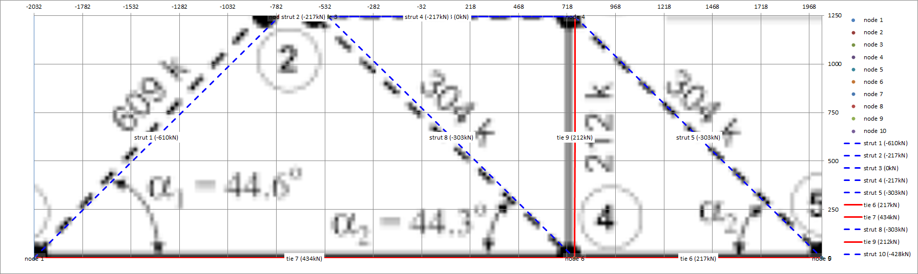

And a little teaser of what I am working on... Everything you see was created by an EXCEL macro (from graphical representation perspective), solved in SMath and presented in EXCEL.
Process of model creation / presentation / solution is fully automated.
By the way, Ioan, SMath solution of this strut & tie worked from the very first attempt - felt like a miracle

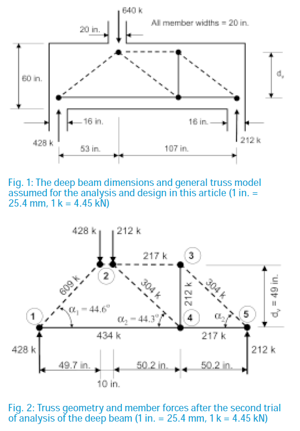

For instance in the appended document ci2505wight.pdf (155.21 KiB)已下载 11611 次。they go to modify the physical height of the beam in order to satisfy the model, what's not usual in engineering.
However, the subject is for specialists and therefor, I decline my intrusions; I'm a specialist but not in this item.
It's strange for me to understand how they obtained that the reaction on the left support is 428k while a simple calculation gives 640*107/(107+53)= 361k and the beam is nothing that a simply supported beam. Does the beam know this forcing "joke" ?

And this little guy took me about 20 minutes to setup.. Mostly defining coordinates and stuff. If the drawing was to scale I could have just located the nodes of my strut & tie graphically.
Small typo:
640*107/(107+53)= 428

Hi All,
Did not expect this topic to spur such a conversation but hey, the more opinions the merrier!
Very impressive and clean truss model, Ioan, looks great.
Side thought - I am not really going "outside from the road" with my solution... simple force equilibrium at nodes. We can chat more.
