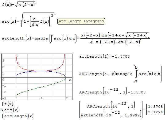

How do I integrate symbolically ?
Generally, like this.
Davide Carpi 2018/5/12 03:23:00
#3 已发布: 2018/5/10 22:35:04
983个赞,共6,866个帖子。
... more procedures.
Integrate_000000 [ Source Code Maple].sm (9.66 KiB)已下载 1379 次。

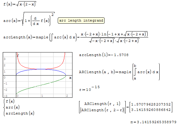

Integrate Wisely [Arc Maple].sm (8.54 KiB)已下载 1095 次。
#16 已发布: 2018/5/11 12:43:56
983个赞,共6,866个帖子。
... be productive to integrate, try it.
#17 已发布: 2018/5/11 13:44:31
983个赞,共6,866个帖子。
... this attached example is of prime importance.
It shows by how much the Simpson integrator can be OFF track !
Not even the first decimal is true !
Integrate Wisely [Arc Lagrange].sm (44.76 KiB)已下载 1097 次。
