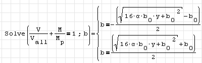

Hi mkraska,
I am getting to use maxima plugin a little bit more and ran in a problem very similar to
http://en.smath.info/forum/yaf_postsm12822_Evaluate-expression-for-a-variable-s--set-to-a-number.aspx#post12822
When I pass to Maxima an expression (using Maxima()) with undefined variables to solve it symbolically it does not seem to work. I have created Maxima workbook to confirm that what I am trying to do is achievable using maxima.
Any ideas?
Screenshot and Smath workbook are attached.
Thanks!

#105 Опубликовано: 18.04.2014 19:00:08
solve() is the SMath built-in numeric solver.
You want Solve().

mkraska,
That explains why solve() function did not work, however it does not explain why Maxima(solve())= function did not work - it should have passed solve() to maxima in which solve() is correct syntax.
Thank you for your help!!!
Maxima() just like any other function in the Maxima plugin translates the arguments only after SMath preprocessing, i.e. substituting all known symbolic expressions and executing all known functions. If a function is not smart enough to return itself if this evaluation fails, then the preprocessing throws an error. In the given case, solve() should return itself if evaluated symbolically.
Switching off preprocessing (you can do that in the maxima debugging window) is not an option, unless you want the arguments of solve() being transferred to Maxima verbatim.

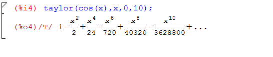

#117 Опубликовано: 06.05.2014 12:26:55
patel75
patel75
I've just restarted SMath after a break of a couple of years and am finding the Maxima plugin is the best thing in SMath since I last used it.
I do however have a minor problem. When doing a taylor expansion, the expression displayed by SMath is being factorised. This is quite annoying for me and I would like to know if there is a way to display the expansion is the standard format as displayed by Maxima. See below.
SMATH output
Maxima Output
#118 Опубликовано: 06.05.2014 12:49:08
SMath Optimization should be suppressed when using Maxima plugin. Right click on the Maxima region and choose Optiization|None
[MATH=eng]Maxima(taylor(g(x),x,0,10))=1-{x^2}/2+{x^4}/24-{x^6}/720+{x^8}/40320-{x^10}/3628800[/MATH]
patel75 07.05.2014 03:51:00

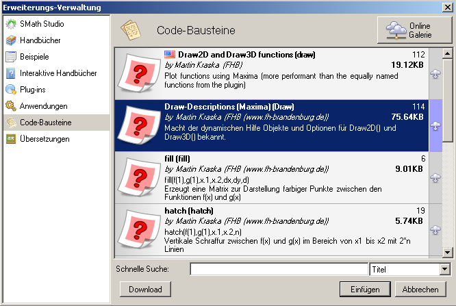

#119 Опубликовано: 10.05.2014 07:42:25
I've uploaded a snippet with descriptions for Maxima Draw2D and Draw3D graphic options and objects. Thus they are known to the dynamic assistant for hints on syntax and for auto-completion.
Shortcut is "Draw"
todo:
- integration of the texts in the Maxima plugin (possibly with config file for adding new texts without re-compilation)
- translation to other language (now mostly german)
- extension to other Maxima functions.
