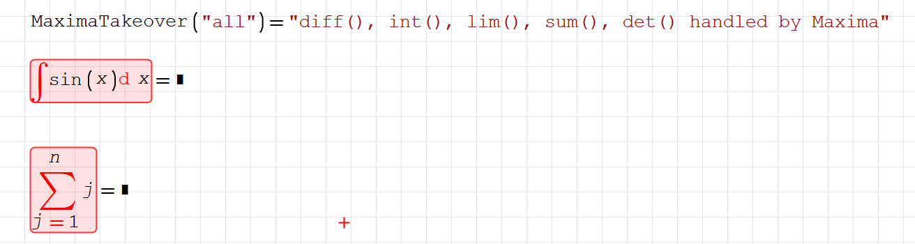

I have a portable version of Smath 0.99.7251. The Maxima is under D:\Program Files\Math Tools\SMath Studio\extensions\plugins\44011c1e-5d0d-4533-8e68-e32b5badce41\1.98.7100.23756\
I put the above path into insert->settings, but it show "Cannot find maxima.bat"
Did you install Maxima? If not, follow the link in my signature and see the instructions for installing and configuring Maxima. The plugin just provides the interface.
Thanks. I installed Maxima 5.42.2.
But still can't get result. SM file attached.
maxima.sm (2.97 KiB)已下载 1717 次。

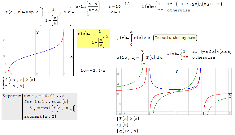

Why so much trouble for ordinary stuff vs Smath Native ?
Thanks Jean, but can't get result either.
error:"x not defined"
maple.sm (2.01 KiB)已下载 1722 次。

put the optimization to symbolic or none

You have to set Optimization to Symbolic or None to display symbolic results. You can also press Ctrl+. instead of = to get symbolic results from an expression.

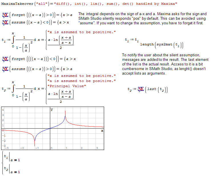

This is an example on how to control the assumptions used for symbolic integration in Maxima.
1-2-4 Widerstandskrafte.sm (12.13 KiB)已下载 1711 次。
2位用户喜欢此帖子
sergio 2020/10/8 15:45:00, IVR 2020/10/10 12:24:00

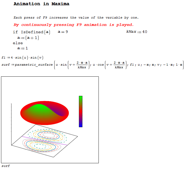

Animation in Maxima
Плагин Maxima не имеет встроенной возможности анимации.
Для создания анимации использовалась программа
https://en.smath.com/forum/yaf_postsm48012_Graph-animation.aspx#post48012
Для записи Gif файла использовалась программа GifCam.
povorot1.sm (74.29 KiB)已下载 1685 次。
SpiralMaxima.sm (45.77 KiB)已下载 1701 次。

Animation in Maxima
Very nice. Here is a version with absolute variables (names starting with ~, not easy to input with german keyboard) for execution counter. BTW, the original version reads temp storage before it is written. This throws an error similar to what would happen if I had not checked for a being undefined.
povorot1_kr.sm (75.16 KiB)已下载 1726 次。
Fridel Selitsky 2020/11/23 19:10:00

Thanks a lot, Martin. Wonderful! I was not aware of the IsDefined function.

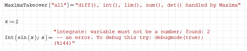

I'am using Smath for quite a while and already tried to use the Maxima plugin several times without any success.
I was able to do the setup as shown here: https://en.smath.com/forum/yaf_postst2078_Maxima-Plugin.aspx
But unfortunately in Smath the Int() function for symbolic integration never works. I'm pretty sure that I'm missing a little part. Can anyone help me please?
Example:
When I do define x I get the following error
And when I do assign something else than a number i get:
#299 已发布: 2021/5/13 17:05:17

This is because you use numeric optimization (context menu). If you expect symbolic results, use symbolic optimization ("none" also works, it shows the result from Maxima without further processing by SMath).
The error message is correct. The integration variable must be unassigned.
... but you have missed the best from Generous Smath Community.
1. Always/first plot the integrand.
2. You integrate over a ranged variate.
3. maple is delivered with native Smath.
