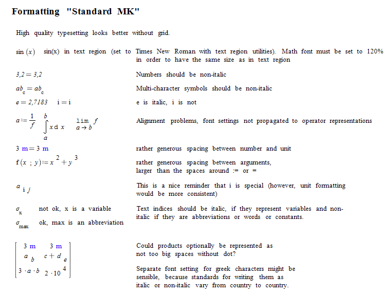

A short test showed the following issues (some of them might be matter of taste). I understand this is work in progress...
formatting.sm (5.5 KiB)已下载 1659 次。
EDIT: The functions are deliberately set to italic in "Standard". Thus this can be fixed using a custom style.

I felt encouraged to play around a bit. I wonder why the font in math regions must be scaled to 120% to result in the same font size as in text regions of the same font.
Perhaps we are entering an era, where people become more picky about appearance issues of SMath sheets. The monospaced text regions become inappropriate now...

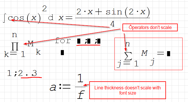

I encountered the following visualization problem in the use of vectorize (equations formatting: Default, Old Style, Standard)
[albumimg]1464[/albumimg]
Davide Carpi 2017/11/10 08:17:00
#12 已发布: 2017/11/10 08:27:07
1,443个赞,共2,936个帖子。
Seems that the boolean operator "greater than or equal to" is not drawn, unrelated to vectorize

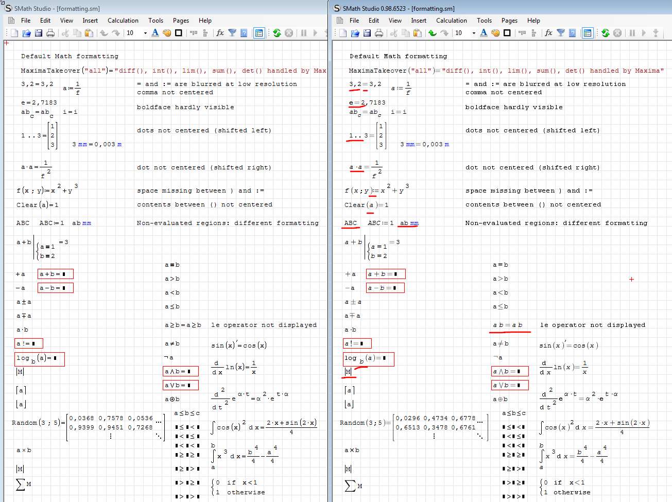

I experience some horizontal misalignments (caret position, empty placeholders, ...), I am the only one?

1,362个赞,共2,276个帖子。
Impressive rate of progress!
At low resolution/small font size, the old formatting is easier to read, mainly due to the blur of the thin-lined operators.
Pasting multiple regions as image is nice.
When the maxima-plugin is downloaded from the gallery and the offer to search for Maxima is confirmed, then the setup dialog automatically closes instead of waiting for user input. The dialog can only be used after next start of SMath.
Feature proposal: pan the canvas by drag with the middle mouse button (as alternative to use the scrollbars)
formatting.sm (27.85 KiB)已下载 1668 次。
