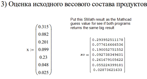

If i use this x0 in MathCad I get the same X未找到文件。. x=X. I tried a lot of p values but I didnt get close result. Results are always too big.未找到文件。

Hi gallyon1. You are looking for a maximum. So, for your problem, bigger is better. SMath returns a bigger result, but that's not all: the results verify all the problem constraints, which make it valid answer for the problem.
Maybe I don't explain well: try to check what happen with mathcad if you use the SMath answer as the guess, this is substitute the x value in Mathcad for the xo value from SMath here:
But actually that's for compare. SMath solution checks all the constraints, then it's a candidate for the problem solution. You "didn't get close result", but I don't see a problem there, where I see a problem is if you want a close result, this is a result near to 8.8*10^8 you need to review your physical system and check if there are some additional constrictions for some variable or function which make your result "close" to that value. If not, SMath solution it's just a good solution, and Mathcad's isn't.
