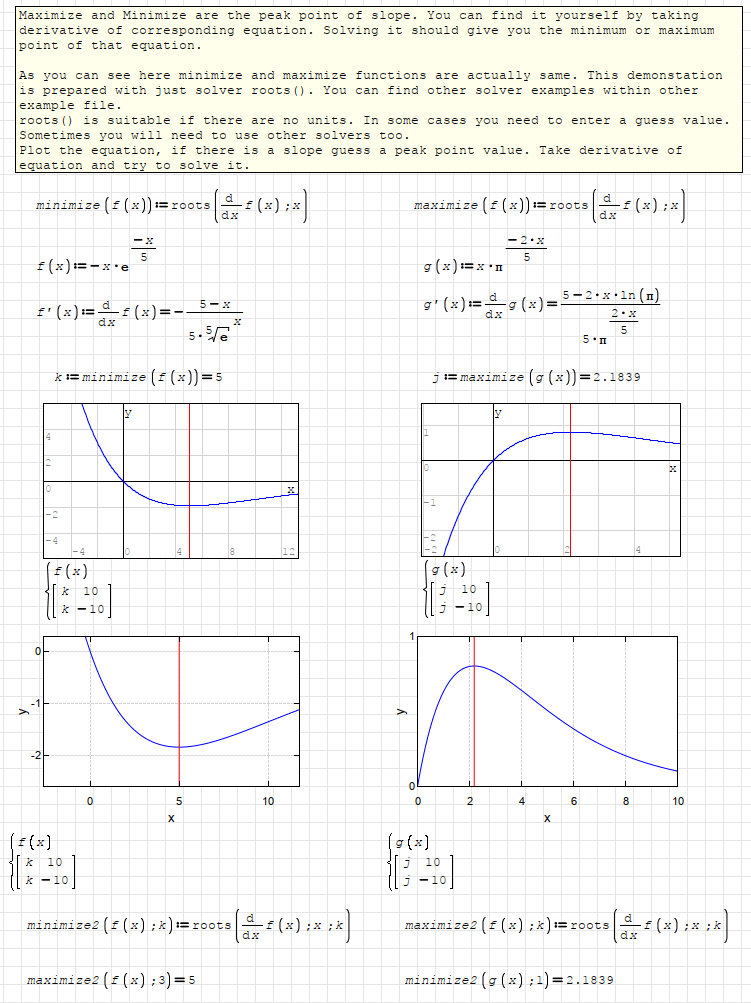

You can write your own functions.
maximize and minimize are peak points of slope.
Take derivative of equation, solve it.
Check the examples below.
maximize_minimize.sm (16.48 KiB)已下载 1232 次。
maximize_minimize with different solvers.sm (28.5 KiB)已下载 1234 次。

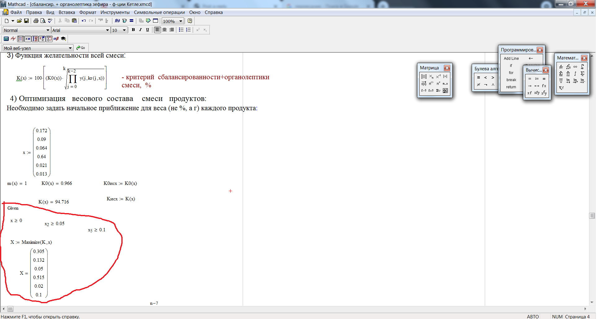

I have a program in MathCad,the problem is that the marshmallow recipe is being optimized here,
I need a maximization function to find the maximum value of each ingredient.
sbalansir. + organoleptika zefira - f-cii Ketle.xls (21 KiB)已下载 868 次。
the exel file contains the values ​​of each marshmallow component that are used in the task.
sbalansir. + organoleptika zefira - f-cii Ketle.xmcd (250.52 KiB)已下载 1298 次。
The whole problem is that the function K(x) is six-dimensional and there is no idea how to find its derivatives.
I need to do the same in Smath Studio, but there are no Given / Maximize / Minimize functions in Smath,
I don't know how to implement this.

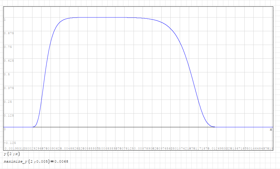

#10 已发布: 2021/4/30 06:31:24
Denis
Denis
0个赞,共14个帖子。
Graphs are doctored and more, but can't sanity more
Cheers ...Jean
diplomnayaRabota.sm (45.97 KiB)已下载 1189 次。
Thanks for your corrections , but the main question was how to get this vector X without the Given and Maximize functions,
because it's obtained from these functions: "X: = Maximize (K, x) ?
The bloc solver Given ... Find, Minerr, Maximize, Minimize
is Mathsoft proprietary specific to Mathcad. No such equivalent Smath.
