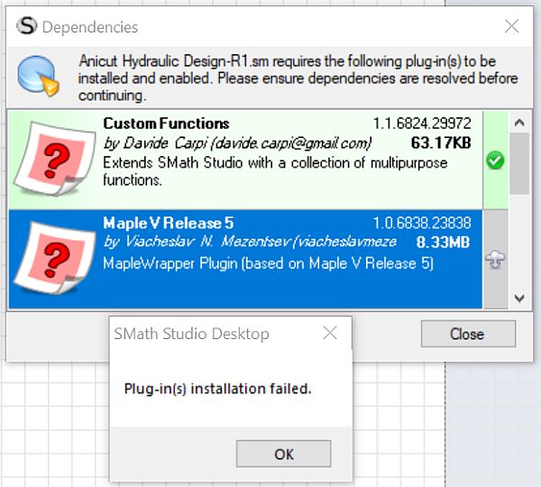

The latest MapleWrapper plugin fails to install.
Tried several clean installation of latest SS, but did not solve this problem.

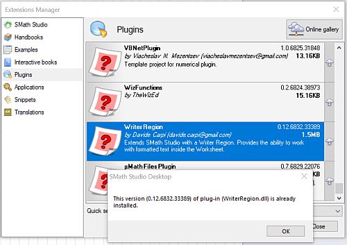

Then I get another problem with WriterRegion. Some link????
The only way for me was to do a clean re-installation without trying to install MapleWrapper, and then WriterRegion can be installed. Any attempt to install MapleWrapper will trigger the same problem with WriterRegion. I don't know why?

#4 已发布: 2018/9/21 14:58:52
1,558个赞,共1,868个帖子。
Try to remove SMath Studio and extensions manually.

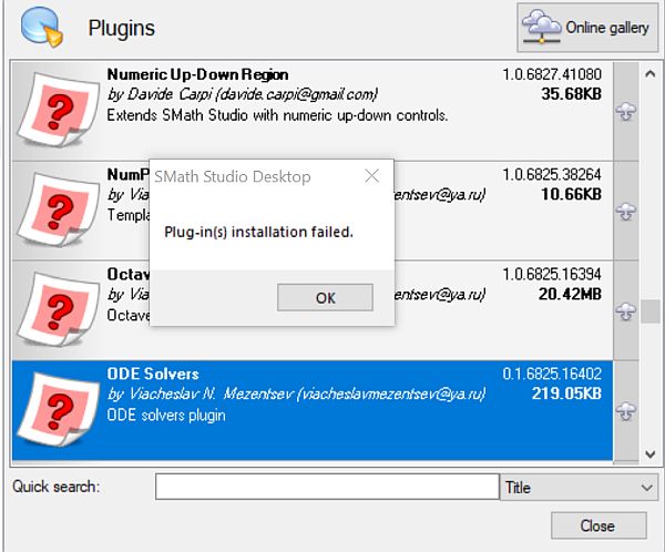

The MapleWrapper new build works now. But see the following. Very strange.
Cannot install TextRegionUtilities also, as indicated by Davide.

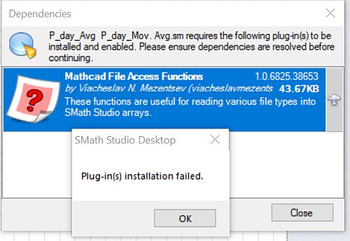

Attached file last opened and saved on 11/09/2018, but now
fails due to MathcadFileAccess plugin failing to install.

#13 已发布: 2018/9/22 13:38:44
1,558个赞,共1,868个帖子。
I think only Andrey can help here. Something wrong with your environment.

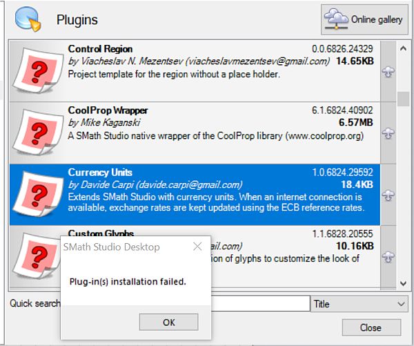

Hello.
I'm aware about this issue. It happens only in the following case:
1) New version of SS released;
2) New version of the plug-in for latest SMath Studio released;
2) New version of the plug-in for old version of SMath Studio released.
In this case there are couple of issues happens on server side which breaks behavior of the Extensions Manager.
It is absolutely clear how to fix this, but it requires a time. I plan to address it as soon as possible.
As for today new stable version of SMath Studio released and if you'll find any issues with plug-ins installation just rebuild and publish plug-ins for this latest version. Issue will gone.

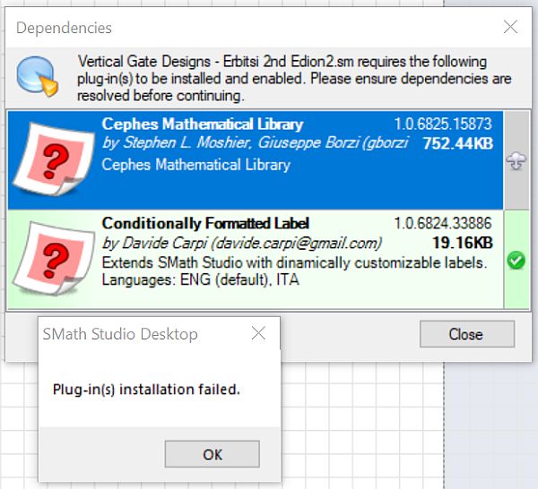

I believe the reason for failure to install plug-in(s) was an Antivirus Program (NOT Kaspersky).
After successfully installing latest SS "0.99.6839.38235" with necessay plug-in(s), problems cropped up again with CephesMathematicalLibrary, MapleWrapper, ODESolvers and a few.
I had to struggle to configure the Antivirus package to prevent blocking installing above plug-in(s).
Now SS is working without any apparent hassle.
