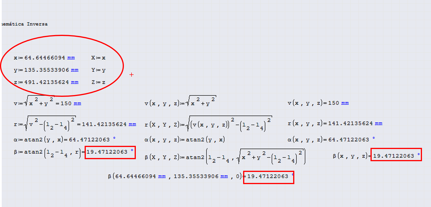

Hi, I am having some issues Here,
As my english is very bad, I prefer to show you the picture about my problem
未找到文件。未找到文件。
If I make step by step caculations, the answer is correct (Which is 19.47°). When I try to make them using user functions, the answer is wrong even if I am using the same values for parameters.
#2 已发布: 2016/4/22 02:50:11
Mike Kaganski
Mike Kaganski
184个赞,共434个帖子。
This is a bug.
The problem is triggered by your naming. You use x, y throughout your functions. It seems that actual parameters names interference with dummy parameters names. Here it's evident: arguments-bug.sm (2.61 KiB)已下载 1361 次。
To workaround, please change names of parameters in your functions, namely in atan2. E.g., you may make it atan2(yy;xx):= ....
Created SS-2327.

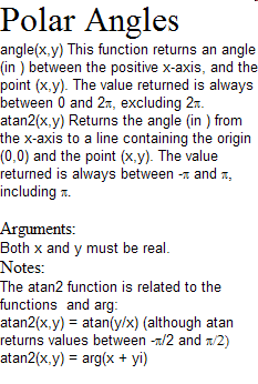

"atan2(x,y) => returns the angle in radian from the 'x' axis to a line
containing the ORIGIN [0,0] and the point [x,y]. The value returned is
always between -π and π including π. Both x,y must be real".
That definition is correct and universal. What's confusing is Smath built-in "mwatan2(,,)
That's why I posted an example for edu/observe. Otherwise Smath angle is even more simple:
x:=64.644 ,,,,, y:=135.355
arg(x+y*i)=64.471393°
'z' in the front end comes out of the blue. If it's further needed, and produces red ?
Maybe some info are missing about what is doing what for what.
Cheers, Jean.

983个赞,共6,866个帖子。
By definition, atan2(y,x)≡arg(x i*y)
Please notice that atan2 has y and x in "reversed" order.
What is "UNIVERSAL IMPLEMENTATION" of atan2? Link please.
Answer: WRONG, bug in your Smath version.
"Universal Implementation" of atan2 is as adopted since the very first day of FORTRAN,
respected in Mathcad 8/11 but not in your Smath version.
