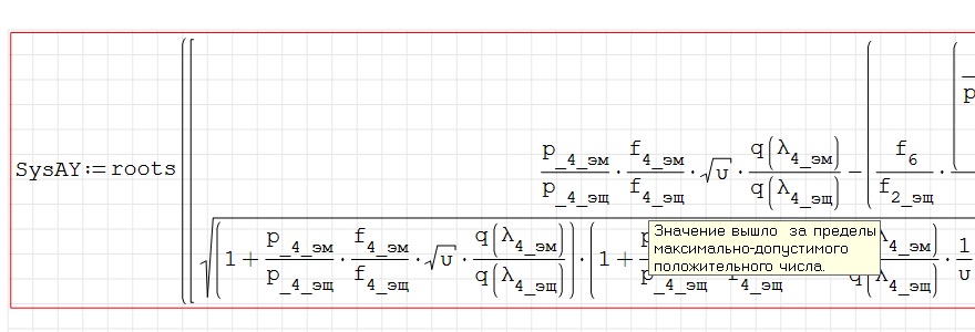

Who has faced such a problem, how can it be solved?

WroteWho has faced such a problem, how can it be solved?
"result above max ..." has no pertinent meaning in your project.
If you attempt "roots" on the numerator only ... "Units don't match"
No need to go further ... zap the units in the project.
WroteWroteWho has faced such a problem, how can it be solved?

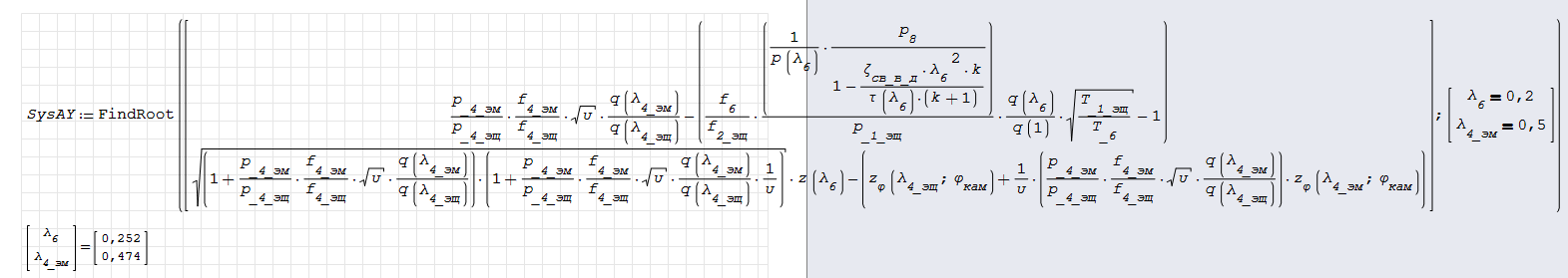

I made a mistake, there should be a solve function, in this place the same error
Common from ill posed construction.
Consider yellow up until you can plot that system(x,y):= ....
from there it should be solvable.
