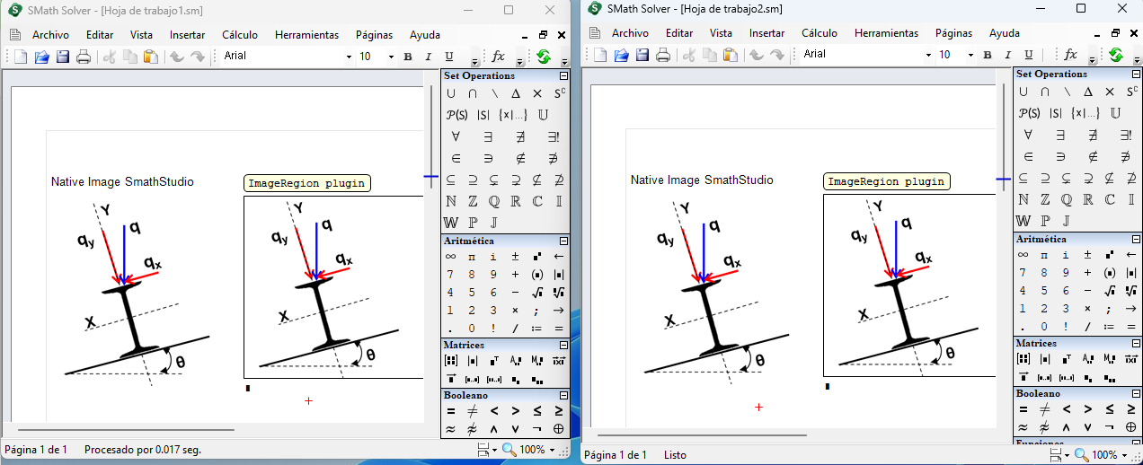

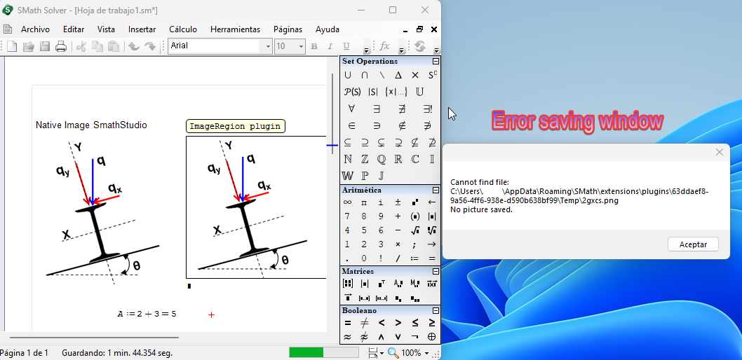

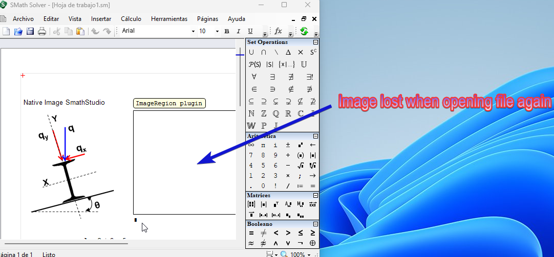

Just start another instance of SMath first, then load the other application in that.
I normally don't start two instances of the application because when closing one of the instances an error is generated in the images inserted with the ImageRegion plugin of the instance that remains open.
I hope you can fix this.
