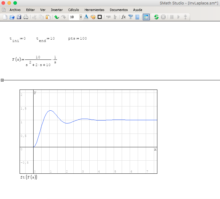

Hi, this is a snippet for numerical inverse Laplace transform. You can find time response of a system expresed in F(s) form.
enjoy
Inverse numerical Laplace

Hello Oscar,
Thank you for this example
By the way, I find very interesting that you defined an expression in this way an then plot it:
Function<->variable
ft() looks like a function, but it is not.

Yes, it's something that I found accidentally. The statement ft(F(s)) appear as a function, but it's a matrix!

I tried to open it using the latest SMath.
I get an error message in the last FOR loop: "Function not defined"
Thanks,
Basile
#5 已发布: 2012/5/30 15:53:17
2,344个赞,共4,057个帖子。
组: Super Administrator
[USERLINK]Basile[/USERLINK], you need to define a function to work with as shown in the first message.

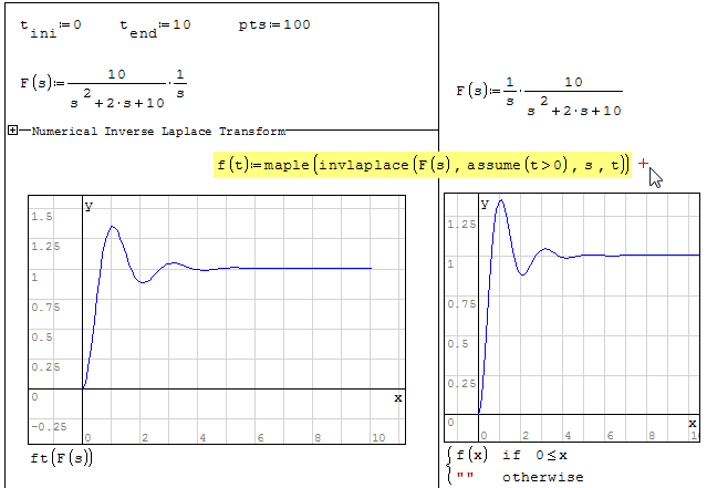

Hi, this is a snippet for numerical inverse Laplace transform. You can find time response of a system expressed in F(s) form. enjoy
This 5 years old document does not work 6179.
Here is the Maple companion.
Only a very little detail to fix this 5 years old document: declare F(s) and change the last line on snippet:
ft( "F(s" ) = augment(t,ft)
for
ft() = augment(t,ft)

Yes, and also it’s possible use f(t)=Maxima(ilt(F(s),s,t)) but it’s interesting show how you can implement inverse Laplace of a function in SMath.
P.D. The symbolic form of f(t) obtained from ilt() it’s more “elegant” than maple version
