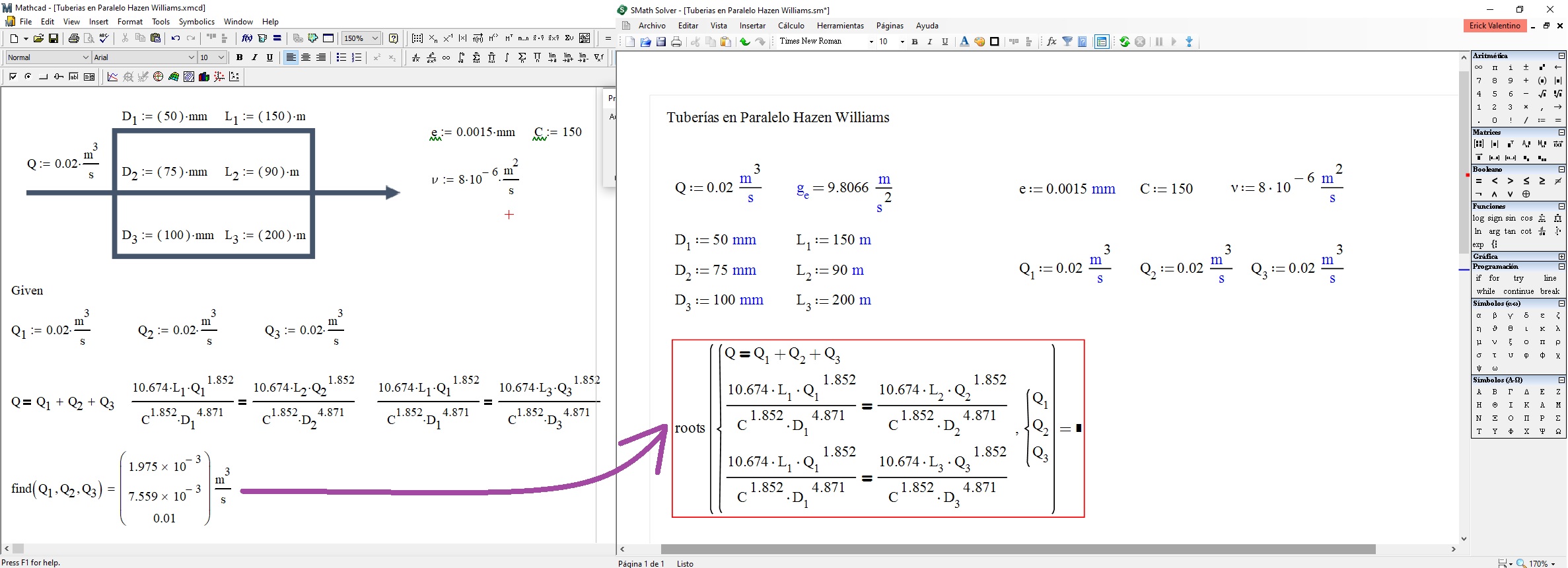

I would like to know how I can replace the "given" command from Mathcad to SmathStudio, I know that such a command does not exist in SMATH and for that there are other tools
I just need to find the flows Q1 Q2 and Q3 from a parallel pipe using the Hazen Williams equation, without having to do as many expressions

Tuberias en Paralelo Hazen Williams.sm (13.37 KiB)已下载 1297 次。
Tuberias en Paralelo Hazen Williams.xmcd (26.7 KiB)已下载 1357 次。

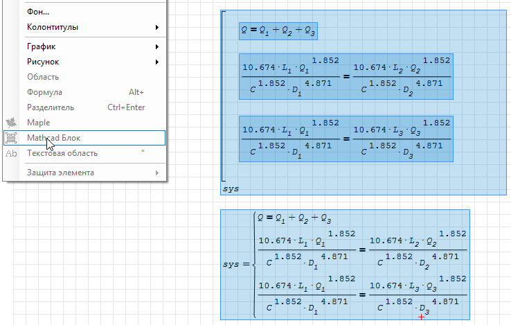

You can use Mathcad Block region for this.

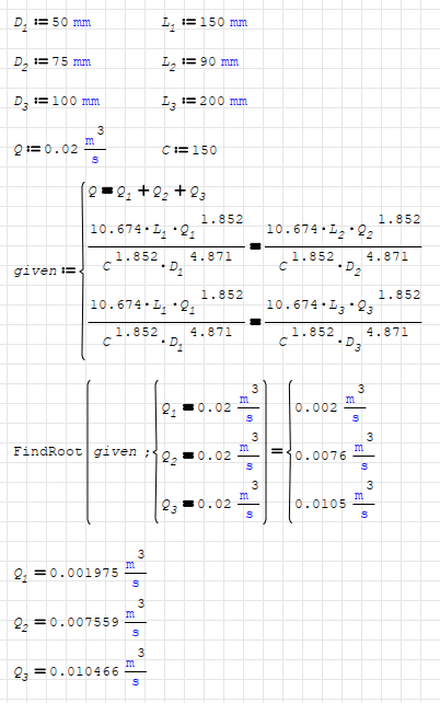

AFAIK, roots() won't work with units.
You can use FindRoots() for that purpose.
Regards.
tuberias.sm (11.75 KiB)已下载 1334 次。

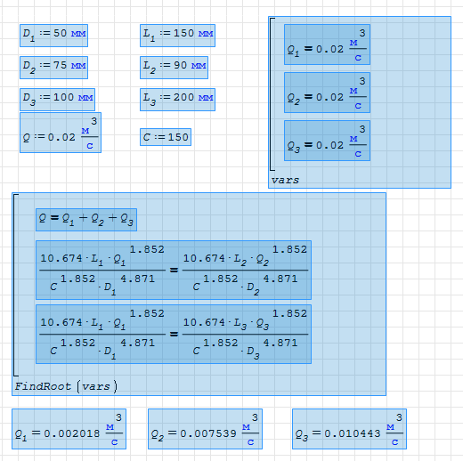

Or like this.
tuberias_uni.sm (12.14 KiB)已下载 1295 次。

#5 已发布: 2022/3/22 20:59:10
600个赞,共1,381个帖子。
Or like this.
What the..? I didn't know you can use mathblock like this.
How FindRoot() can work under block with only one argument?
That is a very neat feature. Really appreciate you share this.
#6 已发布: 2022/3/23 00:32:03
1,558个赞,共1,868个帖子。
The first argument is implicitly substituted by the block itself. Then the function is called with two arguments.
