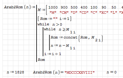

Really it's a very strange bahavior (a bug ?), because the value of variable n is cleared when function returns from Arab2Rom()

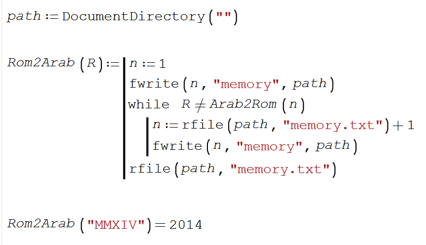

So, a solution is to use functions fwrite() and rfile() to save the value of n on a file as a memory:
See the atachment with the solution: Rome-Arab SOLVED.sm (41.21 KiB)已下载 1549 次。

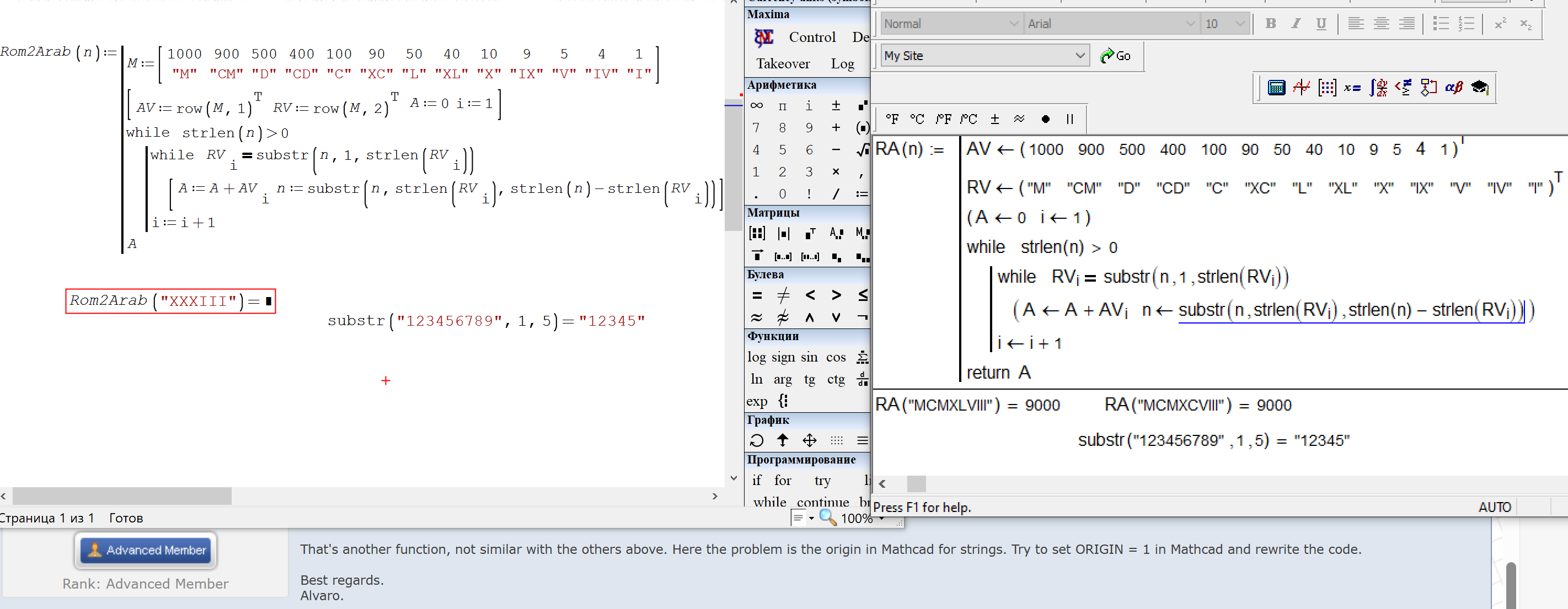

WroteThanks!
But this have an error too!
Rom2Arab.sm (293.29 KiB)已下载 1529 次。

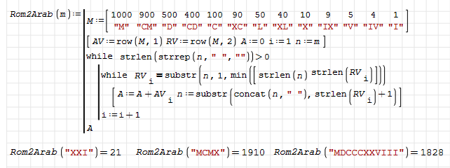

That's another function, not similar with the others above. Here the problem is the origin in Mathcad for strings. Try to set ORIGIN = 1 in Mathcad and rewrite the code.
WroteWroteThanks!

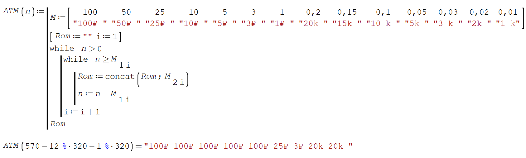

If I remember correctly, 1988 a bottle of vodka (0.5l) was 3 rubles (if you got it at all, it was the time of prohibition - сухой закон). Therefore the 3-ruble-notes.
