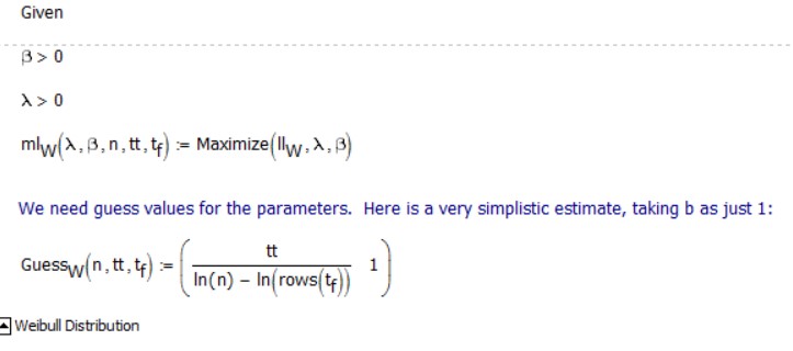

I have tried to convert the attached MC15 worksheet to SMATH. I cannot work around the solve block (Maximize) successfully. I welcome the collabs review and recommendation(s).
The solve block is in the "Weibull Distribution" area (collapsed).
nas

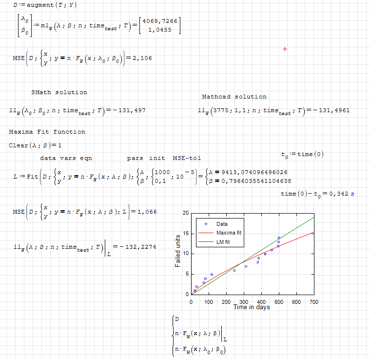

Fit using Maxima's lsquares package. MSE() is the mean square error, which is minimized by Fit()
2018-09-10 11_11_54-SMath Studio 0.99.6671 - [Chain%20Failure%20Weibull%20Analysis%20-%203.sm_].png
Chain%20Failure%20Weibull%20Analysis%20-%203_Kr.sm (78.46 KiB)已下载 1368 次。
frapuano 2018/9/10 09:23:00
#10 已发布: 2018/9/10 09:44:02
Norm Schutzkus
Norm Schutzkus
9个赞,共90个帖子。
Alvaro, jmg and Martin, many thanks!
