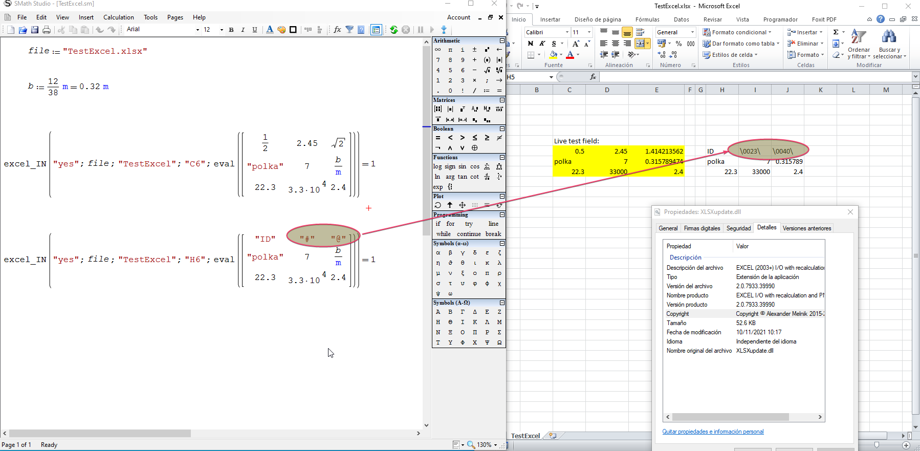

Hi! I'm having trouble sending String variables to Excel.
For instance, ". - / ! ? ;" turns into \002E\\0020\\002D\\0020\\002F\\0020\\0021\\0020\\003F\\0020\\003B\ in Excel.
I'm using most recent SMath and Excel I/O versions.

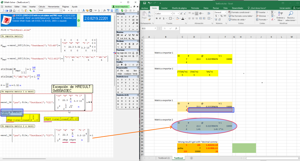

Hello thanks for the plugin, I found a problem in the excel_In() command. I present it in the image, I hope it can be resolved in future versions.
SMath Studio compatibility
Plugin updated. Please try.
Changes:
- ToCell(): Globals.Excel.DecimalSeparator replaced by the CultureInfo.GetCultureInfo( "en-EN" ).NumberFormat.NumberDecimalSeparator;
- ToCell(): Double.Parse() fixed;
- part of the book "Excel 2002 VBA Programmer's Reference" added (Chapter 22. International Issues).

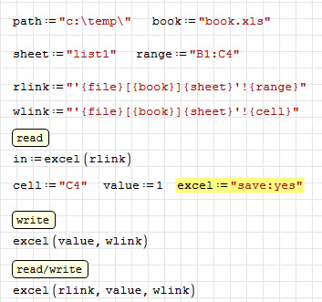

It is possible to simplify the interface. I can add a new feature. You can suggest your own version for a new feature.

In a future release I will remove functions from ExcelIOCom to XLSXupdate. One function and one operand will be added.

1,558个赞,共1,868个帖子。
SMath Studio compatibility Examples
Changes:
- excel operand and excel() function added;
- readCell() and writeCell() moved from the ExcelIOCom plugin;
- examples added;
- refactored.
