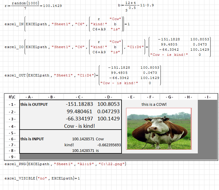

excel_IO - in memory real-time data exchange with EXCEL - can be replaced by separate excel_IN and excel_OUT functions
excel_PNG - exports excel range to PNG file (together with row/column headers, formatting, charts, etc.) - can be used together with Image region.
Function excel_PNG() was modified to take 5th argument – the font size of excel range table headers (set to 0 if none). The PNG export speed was increased to about 0.08sec per screenshot. Functions excel_PNGv0 and excel_PNGv2 are obsolete, however kept for the sake of backward compatibility
excel_PNGv0 - exports excel range to PNG file (together with formatting, charts, etc.) - can be used together with Image region. Function is executed on each SMath recalculation (slow, but twice as fast as excel_PNG).
excel_PNGv2 - exports excel range to PNG file (together with row/column headers, formatting, charts, etc.) - can be used together with Image region. Function is executed only if content of excel range have changed (fast).
excel_VISIBLE - makes background excel process visible in case you would like to take a look at / modify the file

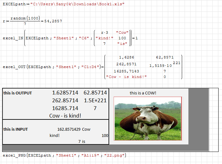

One of the ways to use plugin:
1. Insert image region into SMath workbook for visual confirmation of SMath <-> EXCEL interaction. Use excel_PNGv2 as an argument of the image region, point it to the range you would like to modify in your xls file. NOW YOUR EXCEL WORKBOOK IS OPEN IN BACKGROUND (this step is optional, however handy to visualize your input)
2. Once you visually see the screenshot of your excel file (together with row/column headers) you can use excel_IN to modify particular cells of the file.
3. Insert image region into SMath workbook that refers to your desired output range in xls file (similar to 1, this step is optional, however handy to visualize your output)
4. Use excel_OUT to point to particular cells/ranges in xls file (once you visually identify them from image region).

- When plugin works with excel it makes excel window not visible. Excel becomes visible when SMath quits

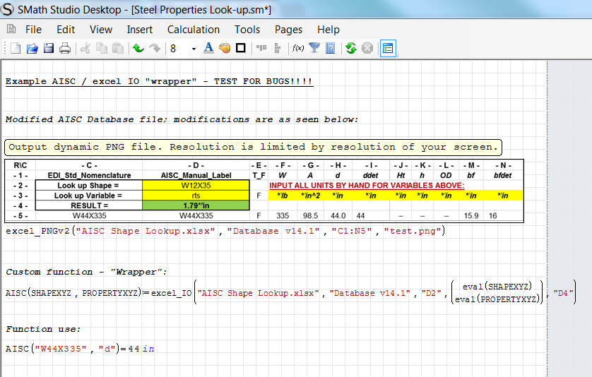

Steel Properties Look-up.sm (25.09 KiB)已下载 2187 次。

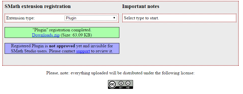

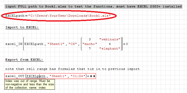

And... There is an error. Screenshot is attached.

Tried today with Excel 2010, i get an "index out of range" exception with excel_OUT and excel_IO (no issues with excel_PNG and excel_IN)

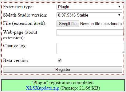

About the registration of the plugin, I've tried and I haven't noticed issues (used just the dll in an uncompresed archive)

Could you please confirm that "index out of range" error is due to file not being specified correctly? Circled is generic path that needs to be changed. I will update the plugin so correct exception is shown.
Error is shown with the correct path and file name "C:\Users\\Desktop\HowTo\HowTo\Book3.xls" and also with relative path "Book3.xls" or "folder\Book2.xls"

Could you help me to debug the error (given it is non reproducible on my end).
I have compiled a plugin .dll that will help to pin point what section of code throws the exception - could you please run it using Smath workbook, xls file and plugin attached and let me know the results?
Thanks!

Done! the error message now is "check input 3 "
If you put the plug-in files in the SMatht plugins directory, you receive this message:
You have to use the plugin in the latest stable version (I use a portable version to test it)

I have attempted properly substituting decimal separator using
引用
result_temp1 = SMath.Manager.Converter.CorrectExpressionString(result_temp1, GlobalParams.DecimalSymbolStandard, GlobalParams.DecimalSymbol, GlobalParams.ArgumentsSeparatorStandard, GlobalParams.ArgumentsSeparator)
hopefully it works (worked for me with comma as a decimal separator, check screenshot).
Attached is recompiled plugin plus "short" version of smath workbook to test all 4 functions.

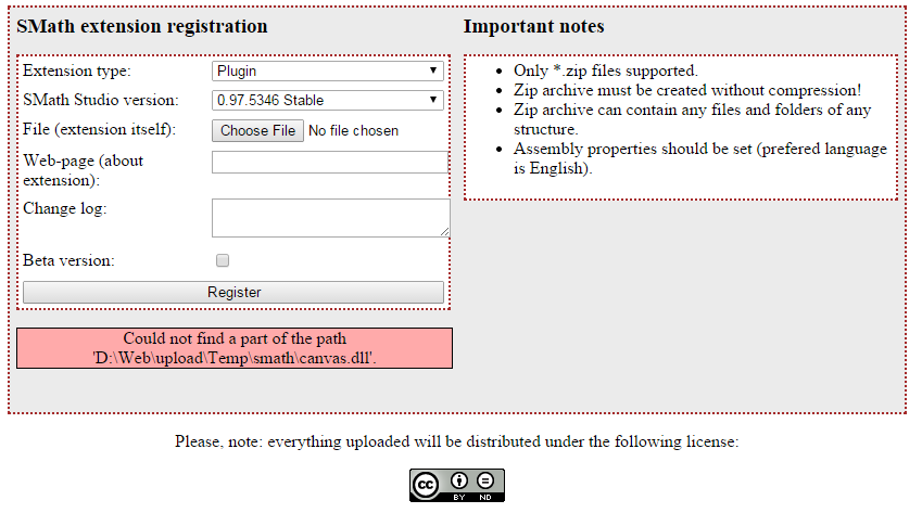

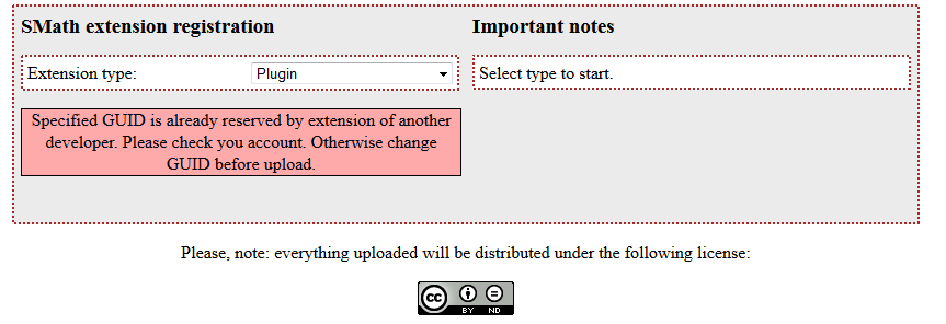

Davide, could you please remove your version of my plugin, i get following error:
#13 已发布: 2015/4/17 18:08:07
1,443个赞,共2,936个帖子。
Doesn't work, the issue is related to the system decimal separator (I suppose the number returned by excel uses the system settings)
Please try again using
result_temp1 = SMath.Manager.Converter.CorrectExpressionString(result_temp1, GlobalParams.DecimalSymbolSystem, GlobalParams.DecimalSymbol, GlobalParams.ArgumentsSeparatorSystem, GlobalParams.ArgumentsSeparator)
Plugin and folder was deleted immediatly after the upload, you have to ask Andrey to access manually the database
Andrey Ivashov 2015/4/17 20:52:00
#14 已发布: 2015/4/17 20:51:55
2,344个赞,共4,057个帖子。
组: Super Administrator
All references to uploaded by Davide extension removed. Please try to register extension again by yourself.

I have successfully uploaded my plugin to extension manager.
Davide, Andrey - thank you for your help!
P.S.: Andrey, I believe you will need to review / approve it.
Approved OK with one comment: please don't include auto generated *.pdb and *.xml files into plug-in package next time.
Thank you!

Update to a plugin - exported PNG includes row and column headings. I find it particularly convenient because one can visually refer to a desired excel cell/range after taking a glance at the spreadsheet screenshot.
