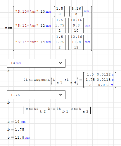

Hello.I have data. I want choosing "a", get only relevant values to choose "b" and output value "c" (if a=10mm; for b there should be options only 1.5 and 2; e.g. selected b=2; means c=8.0mm)
未找到文件。
Question 1: How can I do that?
Question 2: Choosing from a list of values "a" with this assignment of the matrix values are repeated. How to avoid it?
未找到文件。

You may need a temp data derived from first combobox selection.
And use that new data at second combobox.
Here is your both questions answered.
combobox_question.sm (8.36 KiB)已下载 1273 次。

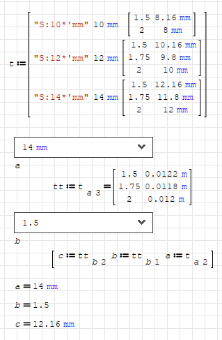

You can reduce data matrix like this too.
combobox_question.sm (8.29 KiB)已下载 1318 次。
Exactly what is needed. Thank you!
