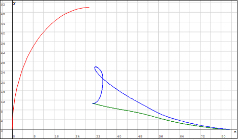

I have traced these three functions, that depend on time, on the graph.

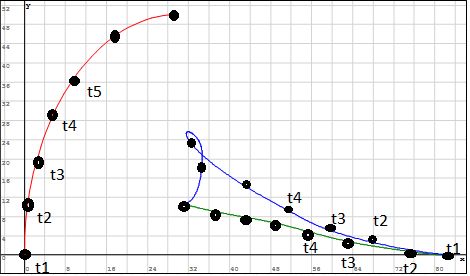

How can I insert numbered points, superimposed on the traced functions, so that the same numbering corresponds to the same instant of time?
To be clear, I should do something like the following figure …
Can you trace these functions from the previously doctored document.
