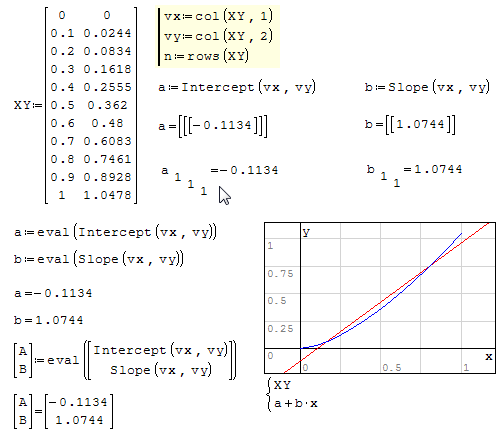

#1 Posted: 2017/12/7 10:26:50
Can't explain to myself double/triple nesting [6179 Win 7].
Bugs SlopeIntercept.sm (10.34 KiB) downloaded 1073 time(s).

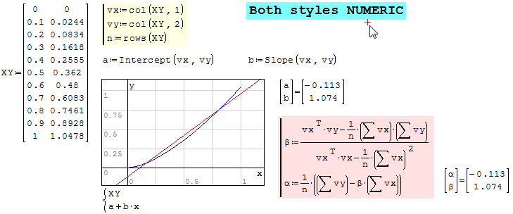

Hello Jean,
something to check in the symbolic engine; change the optimization of a:Intercept(vx,vy) from symbolic to numeric
frapuano 2017/12/7 14:40:00
#3 Posted: 2017/12/7 14:03:58
Thanks Davide ... works fine Numeric !

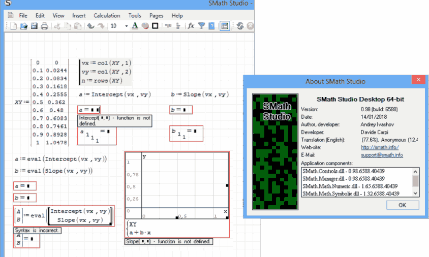

I get these errors when I run the file:

#8 Posted: 2018/1/16 02:02:49

Thanks Jean, but I get the same error.
Is your Smath studio 32-bit?
My Smath Studio 64-bit, does not recognize the
functions of Interception and slope.

Hello!
Jean's example also works in my laptop (Win 10, 64 bit) with latest SS 6588 dated 14/01/2018.

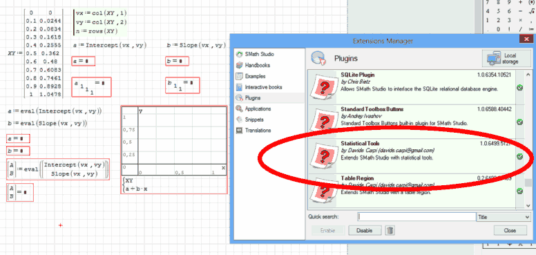

The Functions are in Statistical Tools Plugin.
Carlos, do you have statistical tools plug-in installed and enabled?

Quote
Yes I have it.
