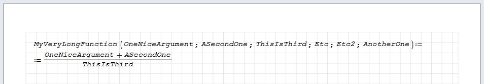

sometimes the definition of a function requires multiple arguments and if you want them to be "self-explaining" (at least to a certain level) you have to use meaningful names for those. All these conditions might bring to a long line before you can type ":" and start with a definition line.
At this point, the space on the paper for statements along the function definition might become a bit tight and the definition itself might be not printable(anything falling out of paper limit will be cutout in printing).
Any chance to have a split at ":=" in order to have the function definition beginning at the left margin of paper?
Something like:
MyVeryLongFunction(OneNiceArgument, ASecondOne, ThisIsThird, Etc, Etc2, AnotherOne):=
|A:= OneNiceArgument + Etc2
|B:= ThisIsThird * AnotherOne
|Calculation:= .....
|ToBeContinued...
Thanks for any help on this subject
Marco
#14 Posted: 2021/4/13 16:21:43
2,326 likes in 4,013 posts.
Hello Marco.
Something like:
|Calculation:= .....
|ToBeContinued...
Yes, it is possible. After you have finished composing formula for definition just put the cursor before := and press Ctrl+Enter. This will produce something like
