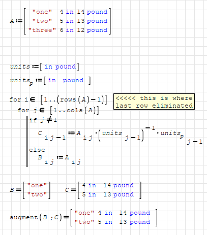

Something like this?
rmRows_rmCols.sm (35.17 KiB)已下载 1371 次。

I believe that rfreund wanted to keep the units of measurement set. I take Davide's solution and I add a trick (I think he had been offered by Overlord or Razonar or perhaps from both).
However, I still have to solve for the strings. Furthermore, if we cancel the columns instead of the lines we should build the units of measurement of the matrix resulting with the same method.
rmRows_rmCols_units.sm (15.7 KiB)已下载 1304 次。

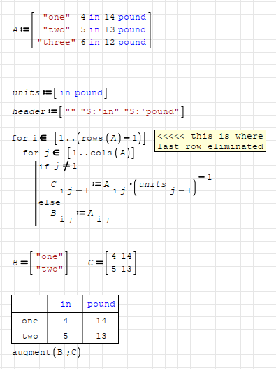

600个赞,共1,381个帖子。
I first see usage of diag() for units by Razonar, then just wrote it as in your example.
Another way is using pseudo units, but this is also not interchangeable.
Again, these are not conventional ways. Just holding your left ear with your right hand.
And there is no solution for string column I guess.
matrix mixed units.sm (9 KiB)已下载 1290 次。

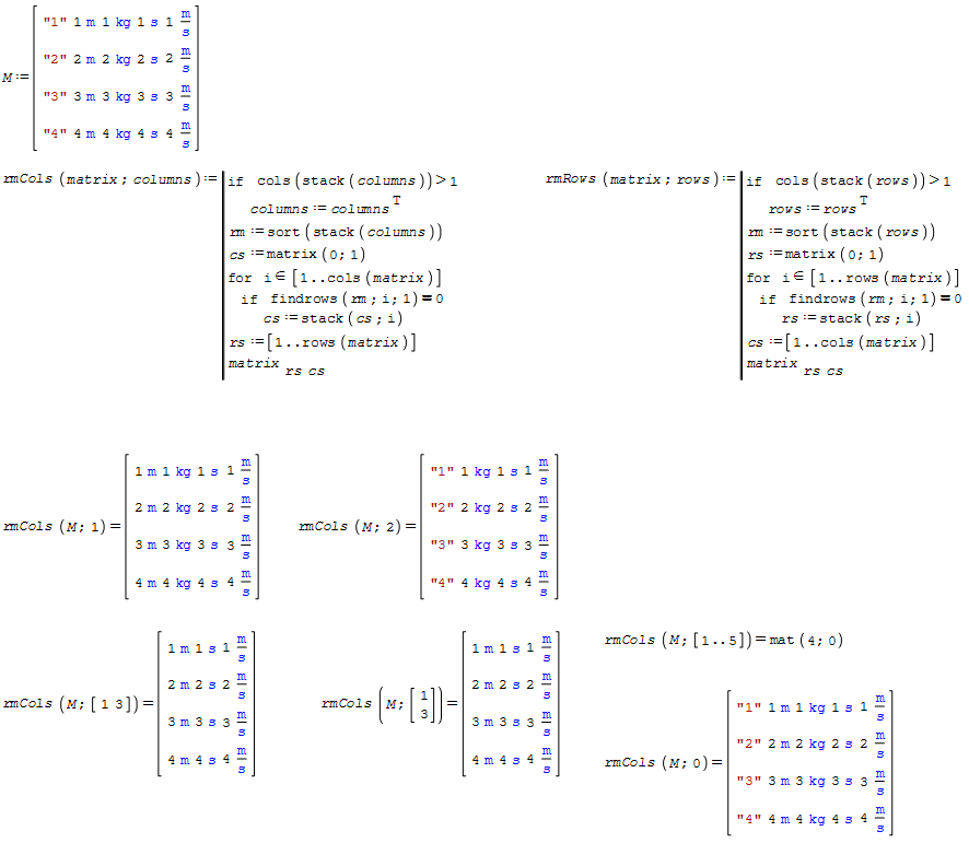

#6 已发布: 2022/9/23 04:26:49
1,362个赞,共2,276个帖子。
One might use vector-valued indices.
rmRows_rmCols_Kr.sm (7.87 KiB)已下载 1322 次。

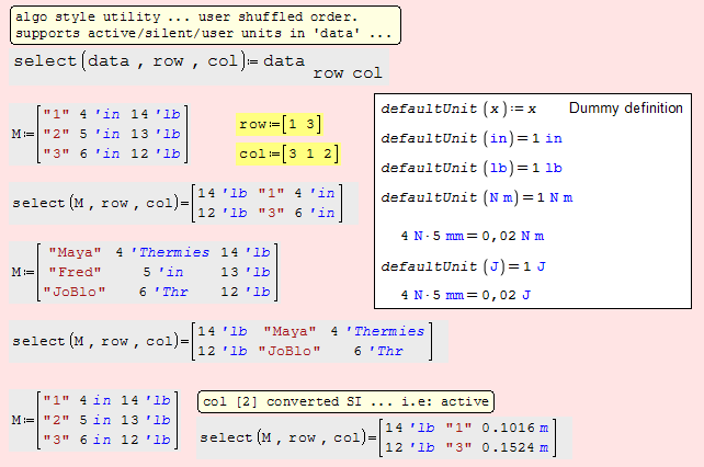

983个赞,共6,866个帖子。
Yes, you can remove the row or column, but no you cannot get it to display in non-SI units.
Smath is delivered with silent units or active SI ...
... silent units as required
Page4 Delete Col-Row.sm (15.27 KiB)已下载 1441 次。

#18 已发布: 2022/11/17 11:38:10
983个赞,共6,866个帖子。
Jean - it took me a minute to understand "silent-units" as I thought the apostrophe in front of the unit solved the unit "display" issue. I guess it does if you only want it to "look correct". Thanks for your efforts.
Silent mode disables the SI unit sub-processor.
Don't miss visiting this great matrix shuffling utility.
Cheers ... Jean.
Utilities Matrix Shuffle.sm (12.31 KiB)已下载 1315 次。
