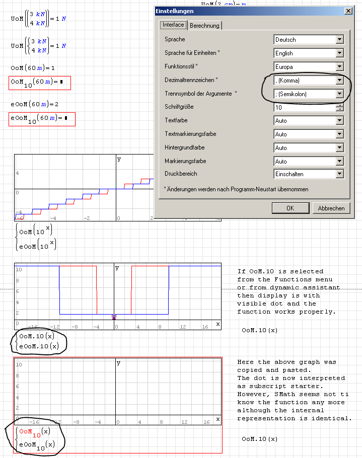

When trying the plugin I had some problems with the functions OoM.10 and eOoM.10. They are related to non-standard settings of decimal delimiter (Komma) and argument delimiter (Semicolon), see image. With standard settings (decimal delimiter dot and argument delimiter komma) no problem.
When choosing the functions from the menu or from the dynamic assistant, they appeare verbatim (i.e. with visible dot and without subscript formatting) but work correctly. If the expression is keyed in or created or copy-pasted, then formatting is done but the function is not known to SMath any more.
Also, if the sheet with the correctly working but incorrectly displayed function is saved and than re-opened, then the display is correct and the function is unknown.
May be the plugin is not to be blamed for this, than this would be a bug in SMath, but I can't tell.
Best regards, Martin Kraska
Davide Carpi 2012/10/3 11:11:00
#6 已发布: 2012/10/3 11:13:13
1,443个赞,共2,936个帖子。
Fixed, thank you

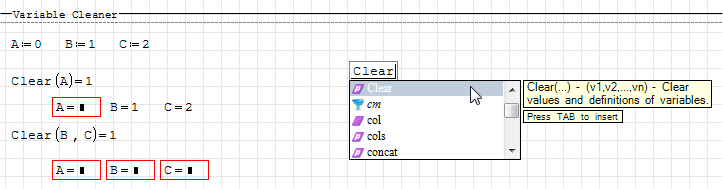

#12 已发布: 2012/11/1 10:08:29
1,443个赞,共2,936个帖子。
PLUGIN UPDATED
- Added Zeros(...)
- Added Ones(...)
- Added mat2sys(...) and sys2mat(...)
- Added Diag(...) - this function, previously shown in a NonlinearSolvers.dll BETA, has been moved in that plugin.
regards,
w3b5urf3r

#13 已发布: 2012/12/14 10:19:50
1,443个赞,共2,936个帖子。
PLUGIN UPDATED
Added new function Clear(...)
Many thank to [userlink]Rising Eagle[/userlink] for the great trick
best regards,
w3b5urf3r

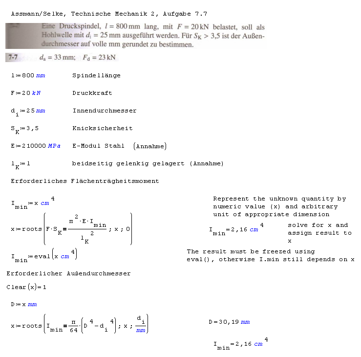

I came across a situation where using a Clear()ed variable is not equivalent to a virgin one. The attached example has two equations, where I introduce a dummy variable in order to solve for the numerical value of a physical quantity (because neither solve nor roots can solve for variables with units).
The approach allows to keep the equation readable and the unit used in the quantity split is arbitrary.
Instead of using a new dummy variable (x,y...) for the numeric value in successive solve operations I tried to always use just one variable. This fails by whatever reason.
The odd thing is that Clear(x) does not help... Thus we do not really have a Clear() function, or did I miss some detail?
Eventually I want to do some experiments with the NonlinearSolvers plugin.
AS 7-7solve.sm (100.55 KiB)已下载 1816 次。
#15 已发布: 2013/1/31 04:03:05
325个赞和1个踩,共2,052个帖子。
Hello Martin,
It seems that Clear() is not doing the job correctly. If I am not wrong Clear(x) equals to line(x), and I suppose it is missing something. If you use the line like Rising Eagle proposed
[MATH=eng]x:line(x,1,1)[/MATH]
it will clear the x and the following roots() using x will be Ok, but line(x) will produce this
[math=eng]x:line(x,#,2,1)[/math]
I do not know how w3b5urf3r escaped from this additional placeholder. If you just use Clear(x) it reported that everything is Ok (result 1) but by using roots() afterwards line-function not defined error appeared. If you use line(x) then there is an empty placeholder and the error would be Fill in all empty ellements. which is logical. Therefore, I suppose that Clear() function needs to be revised. Then, this will also do the job
[MATH=eng]x:line(x,x,2,1)[/MATH]
as could be expected
Davide Carpi 2013/1/31 05:42:00

#17 已发布: 2013/1/31 19:02:53
1,362个赞,共2,276个帖子。
Hello w3bsurf3r,
thanks for the fix! Now that Clear() does the job I see that I have to freeze (using eval) results prior to re-definition of x. Thus the approach with re-using x is a rather cumbersome workaround for roots() not being able to solve for quantities with units.
Martin
#18 已发布: 2013/1/31 21:39:57
1,443个赞,共2,936个帖子。
Hello w3bsurf3r,
Martin
Indeed here I can see one of the (rare) situations where the use of the eval() function is clearly required :-p (see the attachment)

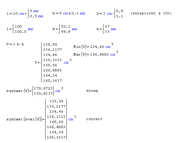

1,362个赞,共2,276个帖子。
Hi w3bsurf3r,
I am surprised by the behaviour of sys2mat, see the attached example. Is this a bug or a feature? For the latter I see no good reasons (ok, i might be blind).
Could the function sys2mat possibly be redesigned such that it does not require eval() in order to produce sensible results?
Martin
#20 已发布: 2013/2/10 12:33:19
1,443个赞,共2,936个帖子。
Hi w3bsurf3r,
Martin
mhhh... probably it's a bug; indeed the sys2mat() function it's quite simple, I'll try to think something a little bit more sophisticated...
