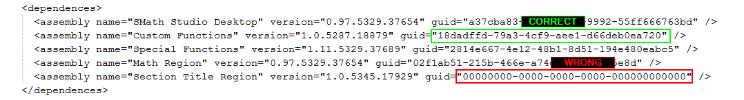

#44 已发布: 2014/8/20 05:14:54
1,443个赞,共2,936个帖子。
Seems that the file was saved using an old version of the plugin; meanwhile standards for plugins design was well defined, so a unique identifier (guid) was introduced for each plugin. It is easy to fix and you can do it by yourself.
Please open your worksheet with a text editor (Windows' Notepad, Notepad++, etc...)
Look at the headers of the XML code; you should see a block of code like this
<dependences>
      <assembly name="SMath Studio Desktop" version="..." guid="a37cba83-b69c-4c71-9992-55ff666763bd" />
      <assembly name="..." ... />
    </dependences>
Also, you should see that the plugin has saved a null Guid
<assembly name="Custom Functions" version="..." guid="00000000-0000-0000-0000-000000000000" />
To solve the issue, replace the null guid of Custom Functions with the official guid
18dadffd-79a3-4cf9-aee1-d66deb0ea720
Let me know if this solve your issues
Best regards,
Davide

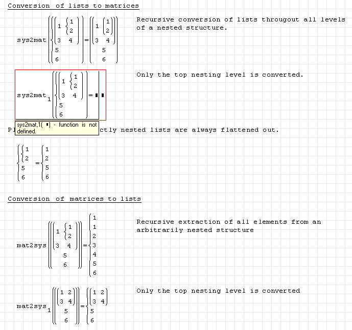

#47 已发布: 2014/9/3 17:34:45
1,362个赞,共2,276个帖子。
Has sys2mat.1() been withdrawn or is this a bug?
#48 已发布: 2014/9/4 08:25:42
1,443个赞,共2,936个帖子。
ops...
I've lost the sources of that update, not uploaded in the SVN, so I've rebuilt the missing functions but seems that I've forget the function. I'll restore it on the next update. :d

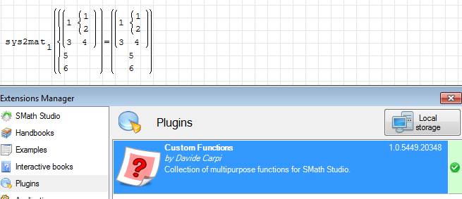

#51 已发布: 2015/9/22 04:02:09
1,362个赞,共2,276个帖子。
sys2mat.1() again seems to be missing...
sys2mat.1.sm (4.89 KiB)已下载 1650 次。
#52 已发布: 2015/9/22 05:11:36
1,443个赞,共2,936个帖子。
works for me... what version of the plugin do you have?
#53 已发布: 2015/9/22 05:51:39
1,362个赞,共2,276个帖子。
seems to be up to date.
EDIT: The function is avaiable, but obviously there have been changes in handling text indices. I choose sys2mat.1() from the dynamic assistant but the .1 won't display as text index. Once I delete the dot and type it in again, then the text index appears and the function becomes undefined.
Here is the system information:
显示剧透
2位用户喜欢此帖子
Radovan Omorjan 2015/9/22 07:15:00, Davide Carpi 2015/9/22 06:12:00
#54 已发布: 2015/9/22 06:08:52
1,443个赞,共2,936个帖子。
Found the bug, I'll update the plugin ASAP

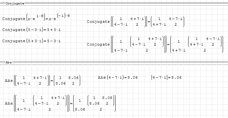

#56 已发布: 2016/1/16 12:40:38
1,443个赞,共2,936个帖子。
PLUGIN UPDATED SMath Studio 0.97.5346 and later and SMath Studio 0.97.5737
  • added Abs(1) (extends built-in abs(1) to matrices);
  • added Conjugate(1);
  • improved description of InterpBilinear(5);
  • refactoring;
2016-01-16 16_42_21-SMath Studio Desktop - [CustomFunctions_examples.sm].png
2位用户喜欢此帖子
ioan92 2016/1/16 12:49:00, sergio 2016/1/16 14:24:00
#57 已发布: 2016/1/19 12:51:21
1,443个赞,共2,936个帖子。
Thank you Ioan, bug confirmed. I'll fix it ASAP.
ioan92 2016/1/19 14:42:00
