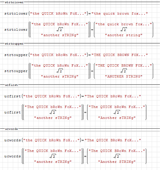

#26 已发布: 2013/3/15 07:05:31
1,443个赞,共2,936个帖子。
PLUGIN UPDATED
  • added new texts functions:
    • strtolower(1): converts all characters in a string to lowercase;
    • strtoupper(1): converts all characters in a string to uppercase;
    • ucfirst(1): converts the first characters in a string to uppercase;
    • ucwords(1): converts the first characters of each word in a string to uppercase;
    all functions works both with texts or texts nested in arrays/systems;
  • added norme(): unofficial patch of SMath Studio norme() function (BUG shown here);
  • sys2mat(): fixed unexpected influence on input arguments.
Plugin's Sources are moved to the SVN repository (I have added a link in the first post)
regards,
w3b5urf3r

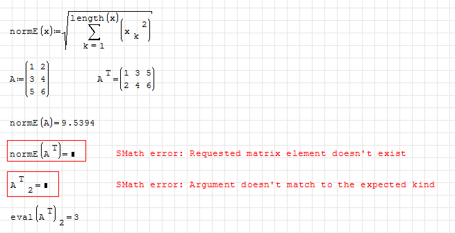

1,362个赞,共2,276个帖子。
Hi Davide,
thanks for the update. I added the functions to the function reference in the handbook and also added a section on string functions.
The norme replacement is highly welcome. I just had a small problem, see attachment.
Just in case you are looking for distraction from real stuff like unit and systems proof solvers:
I'd vote for unit-proof versions of int(), Re() and Im() and arg().
Martin
#28 已发布: 2013/3/16 16:17:55
1,443个赞,共2,936个帖子。
Thank you Martin;
the issue is related with some SMath bug involving transpose and the linear indexing feature ... Tomorrow I'll look in the bug section to see if it has already been reported and I'll update the plugin with your formula

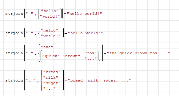

#39 已发布: 2014/6/23 04:17:53
1,558个赞,共1,868个帖子。
Davide, try string.Join().
Davide Carpi 2014/6/23 04:57:00
#40 已发布: 2014/6/23 05:37:48
1,443个赞,共2,936个帖子。
Thank you Viacheslav
Done: added strjoin(2)
Best regards,
Davide
2位用户喜欢此帖子
