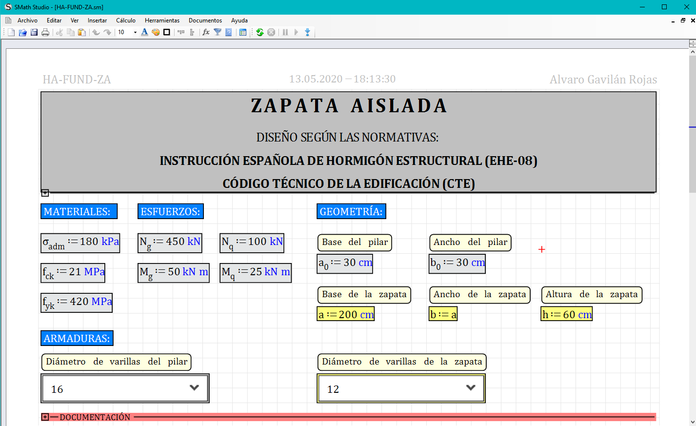

I would rather ask and confirm that this could be a bug report.

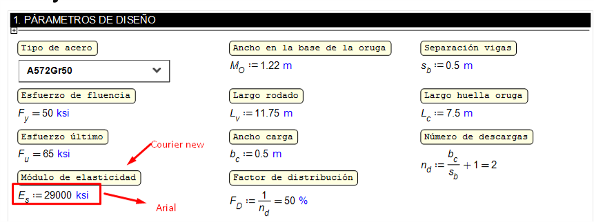

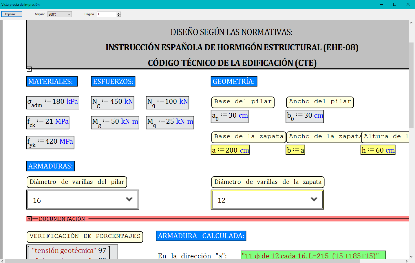

In some description texts for variables, when I print PDF, the font type returns to "Courier New", even after changing the font type in the code (notepad).
Is this a bug? Or there is a way to fix this font type when printing?
SMath capture:
Print preview capture:
Code capture:
File:
HA-FUND-ZA.sm (198.83 KiB) downloaded 1076 time(s).
(SMath Studio 0.99.7030.1435)

I tried it, but unfortunately that didn't solve the problem. The problem is already generated in the SMath preliminar view.

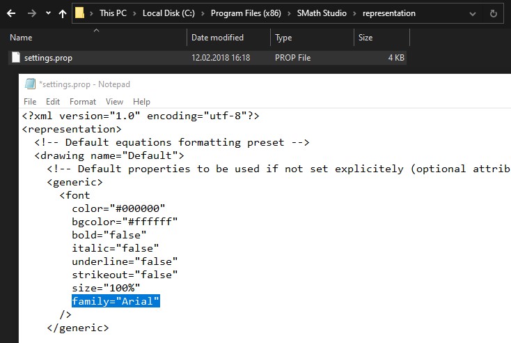

could be restored the capability of changing this by modifing the code in the file setting.prop?
I've checked modification of settings.prop and it works well.
Sorry Andrey, I was not completely accurate. The problem is that now the description text do not change to arial and still on courier new when you change the settings.prop file. Please see the picutre below:

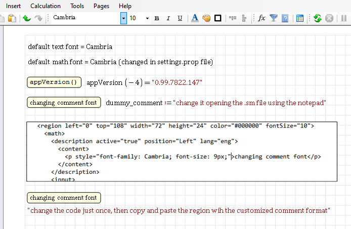

Thank you Andrey for reading this topic. It's the first time I can say THANK YOU for SMath Studio. I hope to further collaborate with this wonderful project, I am at the very beggining of this trip, since I heard about SMath Studio on april, 2020.
Regarding comments, I would be grateful if we can have a simpler way of changing description and math default font types in a worksheet.
As a workaround that could help you, Melo15, I attach here an image that could be useful. Saludos!
Hope it helps!
test comment.sm (14.58 KiB) downloaded 1178 time(s).
