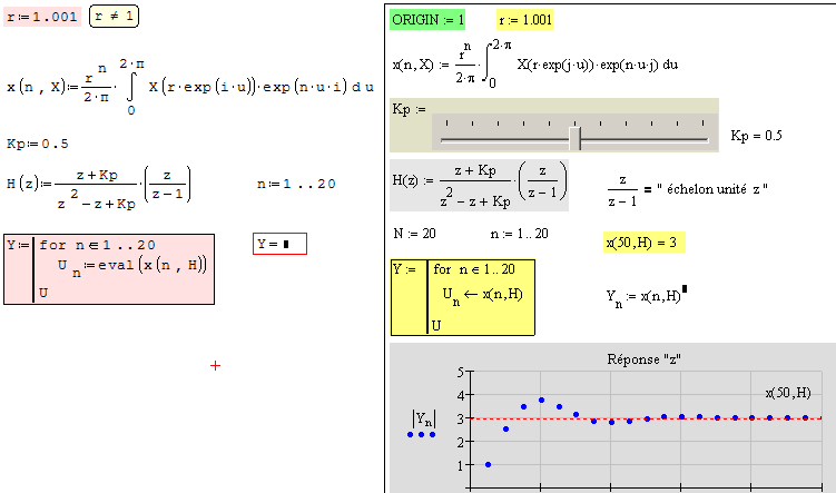

#1 Posted: 2018/12/10 13:39:00
Can't manage this otherwise than shitting bricks !
Solution is welcomed ... Thanks
Done otherwise to rescue the Document.
Inst_PID Discrete Schema EXAMPLE_6 Failed.sm (36.61 KiB) downloaded 969 time(s).

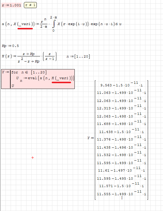

In order to pass functions as inputs to other functions you need to declare it as such and pass a "dummy" variable. See following.
There is still a problem in that it is not evaluating properly, I believe.
Inst_PID Discrete Schema EXAMPLE_6_Partlyfixed..sm (44.75 KiB) downloaded 946 time(s).

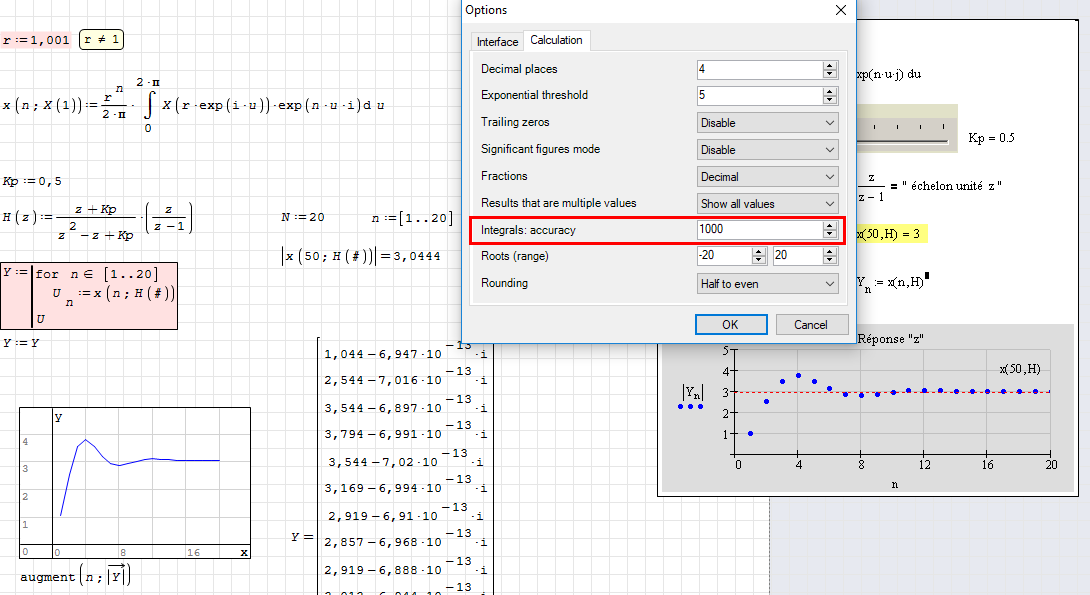

#4 Posted: 2018/12/10 20:29:36
1,441 likes in 2,932 posts.
fixed
Inst_PID Discrete Schema EXAMPLE_6 - fixed.sm (46.19 KiB) downloaded 1009 time(s).
2018-12-11 00_34_33-SMath Studio - [Inst_PID Discrete Schema EXAMPLE_6 - fixed.sm].png
  • removed answer requested for first argument of the last system;
  • used f(number_of_arguments) function of function argument (more elegant, point out that the variable name doesn't matter);
P.S. To obtain similar results, change the integration accuracy to something higher than 100
2018-12-11 00_53_52-SMath Studio - [Inst_PID Discrete Schema EXAMPLE_6 - fixed.sm_].png

Dumb question maybe, but how do you get the '#' to show up in the H(#) function call?
#6 Posted: 2018/12/11 00:50:47
As simple as that: x(n,X(▄)) ... simply the native dummy argument
big square imitation Alt220 ... try it.
Thanks all you Doctors ! Just refreshing that huge collection
of PID examples, coming soon.
#7 Posted: 2018/12/11 01:04:47
... like this:
#8 Posted: 2018/12/11 04:44:48
CTRL+K then #
:d
another option, yes

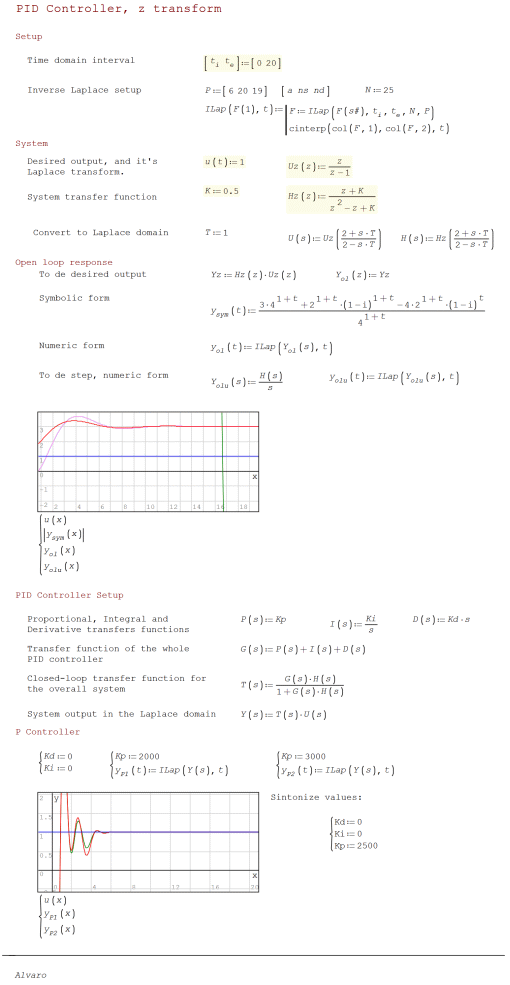

#9 Posted: 2018/12/13 19:02:18
1,106 likes in 1,784 posts.
Hi. This is the setup for use inverse laplace transform for numerically evaluate the response for a system in z domain.
pid_controler z.sm (50 KiB) downloaded 979 time(s).
