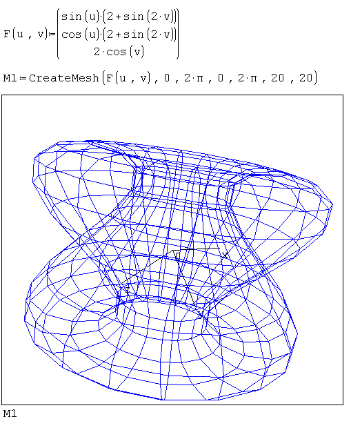

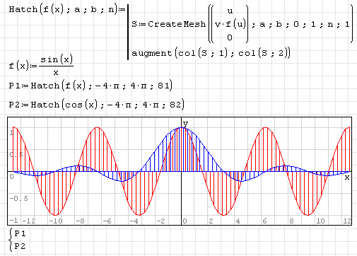

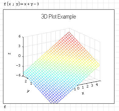

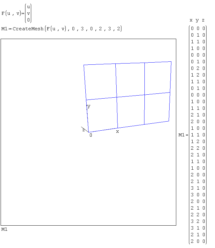

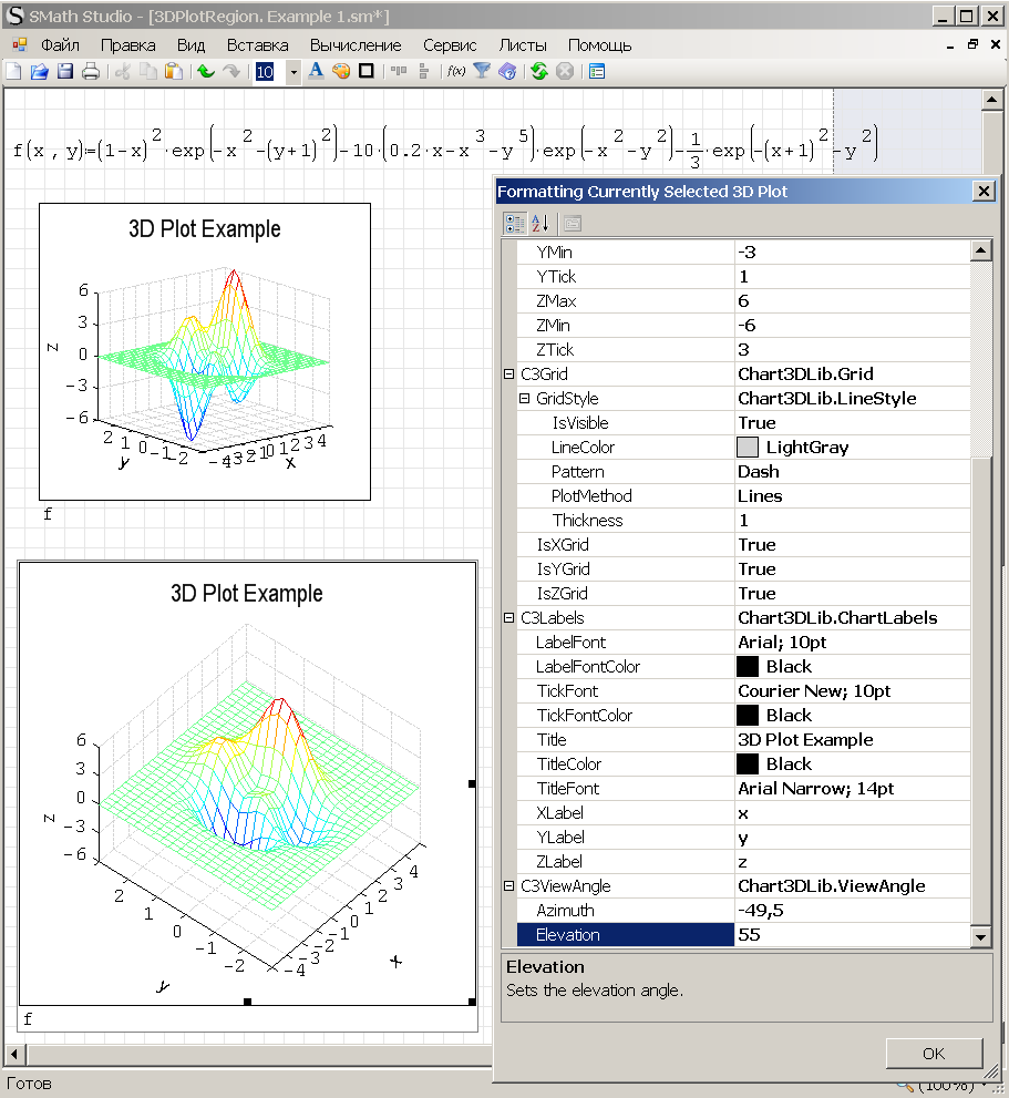

3DPlotRegion_screen1.png 3D Plot. CreateMesh. Example 3.png 3D Plot. CreateMesh. Example 1.png 3D Plot. CreateMesh. Example 2.png 3D Plot. CreateMesh. Example 4.png

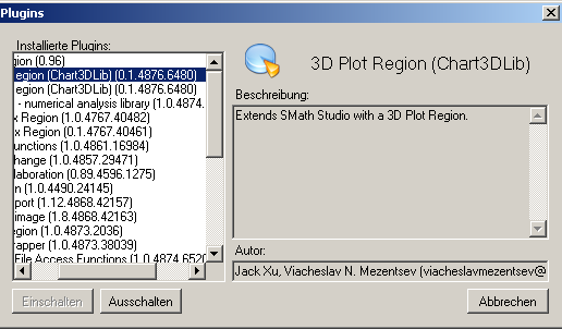

Thanks for the update. I installed the updated version and removed Plot3D.
now the 3DPlotRegion plugin shows up twice in the plugin manager, see attached screenshot.
#13 已发布: 2013/5/7 18:46:03
1,558个赞,共1,868个帖子。
Updated. Function CreateMesh() moved from the Plot3D plugin. Do not use it any more.
Don't worry, this is normal. Andrey will correct it.

CreateMesh() is useful for 2D plots as well...

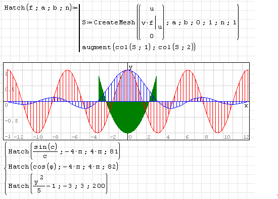

Is it possible to use augment(u;v;f) on 3DPlot plugin, like we use on a X-Y Plot plugin? (u;v;f are vectors).
rod_spring.sm (32.11 KiB)已下载 2132 次。
