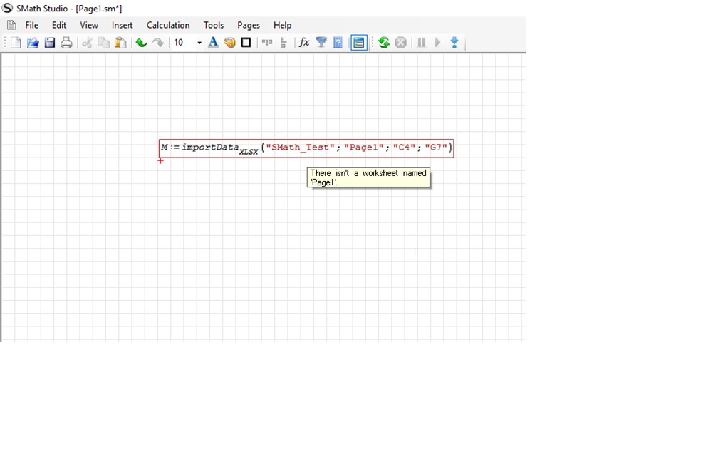

I still don´t get the way how to import xlsx files into SMath files.
It seems, that the xlsx file is found, but there is an error, which sais
my SMath file doesn´t exist.
Would be happy about your help.
Thanks.
G-Tate
#5 已发布: 2018/10/22 12:31:54
1,139个赞,共1,805个帖子。
Hi Tate. The word unavaible "Page1" worksheet isn't about a SMath file, it's about a "Page1" worksheet in the "Excel workbook" named "SMath_Test" (without extension), which I guess that don't exist too (because the name of the Excel file requires the extension, not only the name).

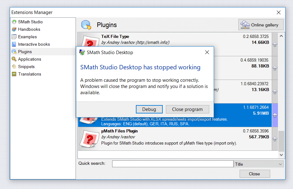

Igor Skarine
Igor Skarine
14个赞,共97个帖子。
Hello Davide,
The plugin doesn't work with the latest Smath beta.
It crashes right away during plugin installation:
I tried it in office on Win10 and at home on Win 7,
all the same. I'm using 32-bit SS on 64-bit Windows.
Davide Carpi 2018/10/24 12:52:00
#9 已发布: 2018/10/24 12:54:08
1,443个赞,共2,936个帖子。
Thank you, confirmed.
Latest release deleted.

Gowand Gravi
0个赞,共22个帖子。
Thank you very much guys!
I didnt get, that the second name needs to be the sheet name from the excel workbook.
I just tried it with the smath file name.
I should´ve think about it, that the import anyway goes to the actual smath file.
:d
G-Tate
