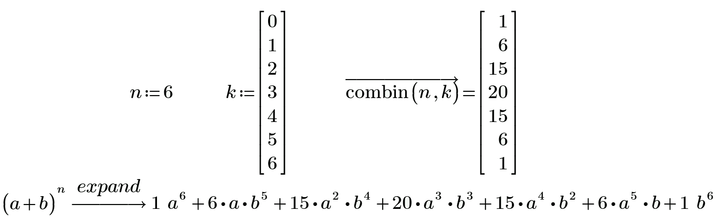

Can I do this with SMath/
See please Mathcad
#2 已发布: 2023/6/19 11:59:41
Valery Ochkov
Valery Ochkov
67个赞,共716个帖子。
I know how create the first part. Has SMath the expand operator or some one?
#3 已发布: 2023/6/19 12:21:12
983个赞,共6,866个帖子。
Can I do this with SMath ?
Smath offers more.
Maths Combine.sm (76.61 KiB)已下载 1357 次。

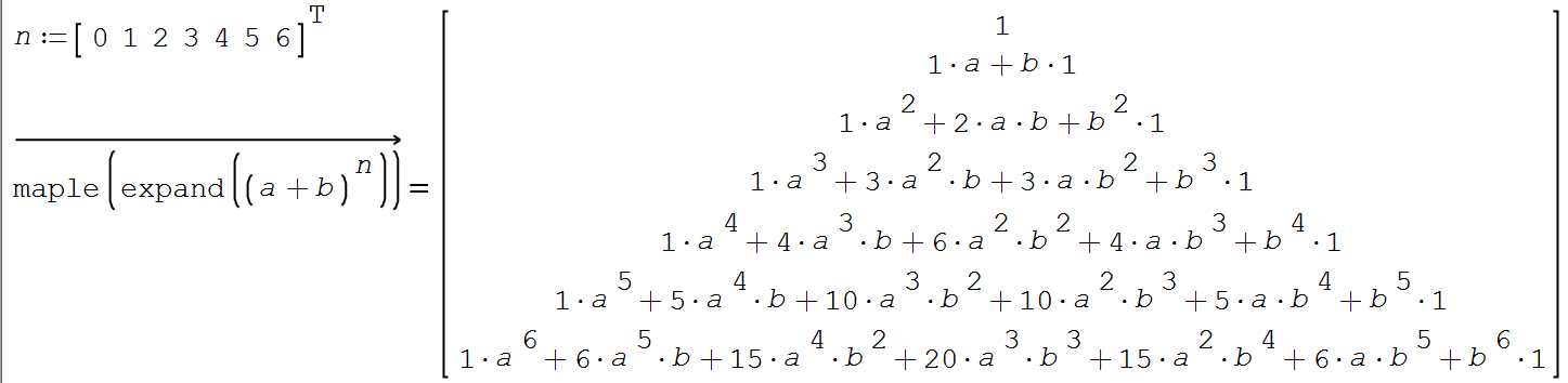

#7 已发布: 2023/6/19 12:40:56
983个赞,共6,866个帖子。
Your two demands honored.
#8 已发布: 2023/6/19 12:55:47
Valery Ochkov
Valery Ochkov
67个赞,共716个帖子。
Pascal triangle

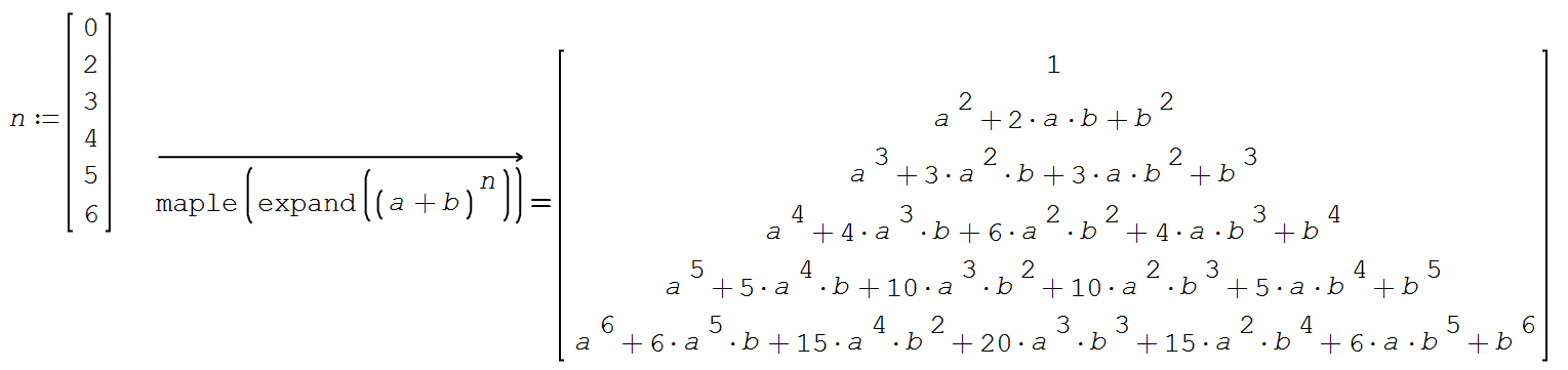

#10 已发布: 2023/6/19 18:23:49
983个赞,共6,866个帖子。
Pascal triangle
Maths Pascal Triangle QUICK.sm (48.15 KiB)已下载 1323 次。
Valery Ochkov 2023/6/20 00:26:00
#11 已发布: 2023/6/20 00:17:21
Valery Ochkov
Valery Ochkov
67个赞,共716个帖子。
Pascal triangle

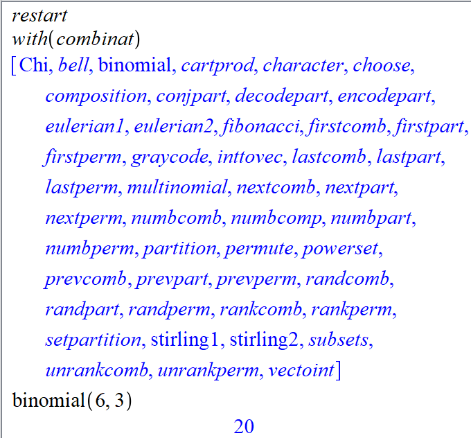

#17 已发布: 2023/6/21 16:06:18
1,558个赞,共1,868个帖子。
Usually, when working with Maple, you need to specify the name of the used package using the with() keyword.
To simplify the work with the maple() function, I make an indication of the packages used implicitly. When calling a function, a certain set of packages is always added.
These packages are listed as commands in the with.inc file. This text file is located in the Maple Tools plugin folder. In one of the subfolders (it seems bin).
You need to add the following text to the contents of the file:
with(combinat):
After adding this line, it will be possible to call functions from this package.

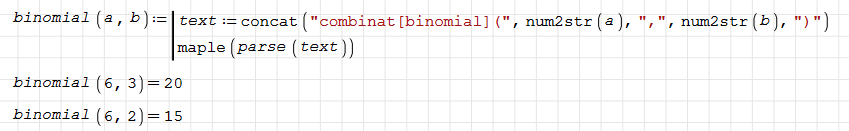

The function can be called like this
#20 已发布: 2023/6/22 10:49:51
983个赞,共6,866个帖子。
How do you add this to the plugin? Could you show this ?
Does binomial work on your system ?
Maths Pascal Auto Companion QUICK.sm (4.89 KiB)已下载 1316 次。
