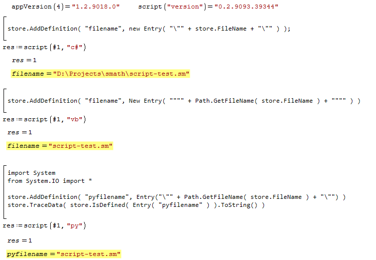

As a temporary solution, I decided to add a function that can execute text scripts. Unfortunately, I can't build a working plugin on the server, so for now I'm just showing how it will work.
2位用户喜欢此帖子
