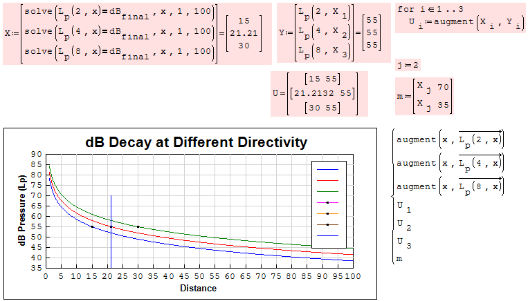

OK, here I am as I had done most of the items that Davide and Jean added. Now I would like to add a "dot" or a vertical line where the dB.final is. Please use this sheet
Quick Sound Loss.smz (135.1 KiB)已下载 1277 次。
Jean, I did not see where you used a spline
All should I be using "cinterp" to place the "dot?

Something like this?
Quick Sound Loss - rev.1.sm (134.93 KiB)已下载 1189 次。
#10 已发布: 2018/4/10 19:43:06
983个赞,共6,866个帖子。
1. spline is for line style ... line/spline.
2. what that gyzma #,#,#,,,does in maths ?
3. X_Y plot does not support " in your plot suggestion
4. X_Y is for final/final/final ... project
once done, if you rework something above=> it will freak the plot
X_Y plot has slightly pregnant memory. Doctored in red .
Quick Sound Loss (3).sm (140.83 KiB)已下载 1464 次。
Carlos,
I think you attached the wrong file. Yes, that is what I was looking for.

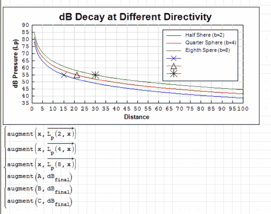

I found a quirk. Depending on values dB initial values, neither solve nor FindRoot is functional. I was plugging in values by hand without seeing an issue. I tried a "higher" dB set of values (86 vs 75) for equipment and the calculation *zap*
Quick Sound Loss.smz (168.74 KiB)已下载 1311 次。
Also, the X-Y plot legend information *ZAP*

Found the issue(s). See revamped file. Still having issues in that X-Y plot Labels for the legend *zap*Quick Sound Loss.smz (142.28 KiB)已下载 2075 次。
Edit: Two bugs
  1. X-Y Plot. If functions crash, *Zap* to the legend titles. All other titles OK. Legend is empty due to laziness after last 5 crashes
  2. solve(4) did not like trying to cancel units in the denominator of the final function (#dist). As I was adding units to x:0-100 FT and dividing the units meters in the function, the function crashed in the solve block (Just the function, with all values plugged in except for x = vector, so it's a solve(4) issue).
This is one of those sheets where UNITS are huge! The equations are all based off of SI/metric references. Major issue
There is additional documentation and function definition updates. Sanity check the graph x scale (adjusted for feet since I'm in the US). Should be good now

Found the issue.I'll post revamp file.Still having issues in that X-Y plot Labels for the legend *zap*
Clik on "list", edit "series name".

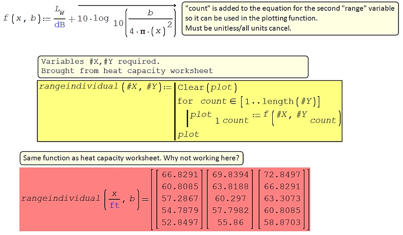

Revisiting this old calc with SMath newer features and some function definitions.
  1. No longer works if I redefine the logarithmic sum with vectorize
  2. I cannot get the "heat capacity function" to work for ploting
Sound Loss (Quick).sm (476.36 KiB)已下载 1340 次。

Hi. Some notes, but I'm not sure if this solve all of the issues:
1. Use count inside rangeindividual, but not outside. You use it in f(x, b ), and guess that could be problematic.
2. After that, you divide x by 'm in f and x by feet in rangeindividual, choose only one.
3. Maybe here don't affect, but if rangeindividual have not f(#,#) as parameter, define f before rangeindividual, you know, just in case.
